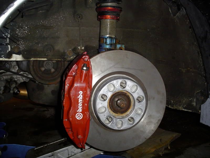

got new spacers from craig used to smaller ones to space it out a little over 1/2in. I have now got good clearness on the brembo to rim. I will put it on the car to night to check it all out.

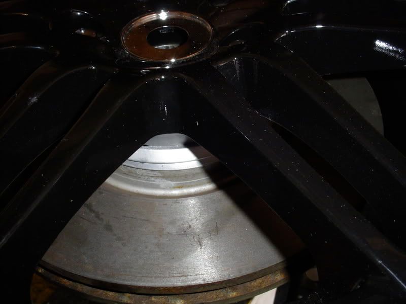

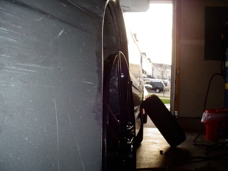

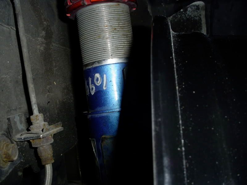

well I got it put on the car tonight to make sure it will all work. I have 2in of back spacing from the rim to the cusco coils. The rim sits with in the fender still with the little over a 1/2in spacer plates. I used a jack to compress the suspention to make sure also and was all good to go. So it is a full green light for the fronts no I just have to order the good 1/2in spacers for it. I am also pretty sure this is the first early evo with evo 8/9 brembos on it and 18*8 rims. Did it at craigs house sense the girls were doing there wedding invatations

Looks like you will need extended wheel studs to have the spacers fit.
TkrPerformance 05-13-2008 05:29 PM
Re: the evo 3 swap parts are coming
as it is right now it was all for mock up sense I can get the spacers from craig and bring them back when I am done. I am going to get H&R 15mm spacers with the evo center ring and they come with the extended studs.

lol. will have to see if your rims will fit also. we tryed craigs last night and it would need more spacer for his
eclipse_spyder 05-13-2008 07:34 PM
My brembo's fit fine with H&R 15mm spacers and extended studs although my brembo's are not the Evo VIII's. My wheels were 18x7+42 offset
TkrPerformance 05-13-2008 07:44 PM
but the evo 1-3 and 1g knuckles are not even close to 2g knuckles. I will be putting the evo 8 brembos on my spyder also. All evo brembos 5-9 are the same caliper.

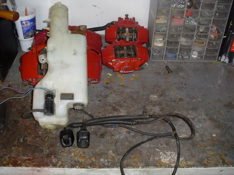

some new up dates on the car. Last week I went to the junk yard for parts for the wifes 1g that I did not have. I ended up picking up a mazda washer bottle with the motor in it so I can hook up my fmic sprayers. I just have to order a alky/meth injection boost pressuare switch for it.
http://i122.photobucket.com/albums/o...o/DSC03793.jpg

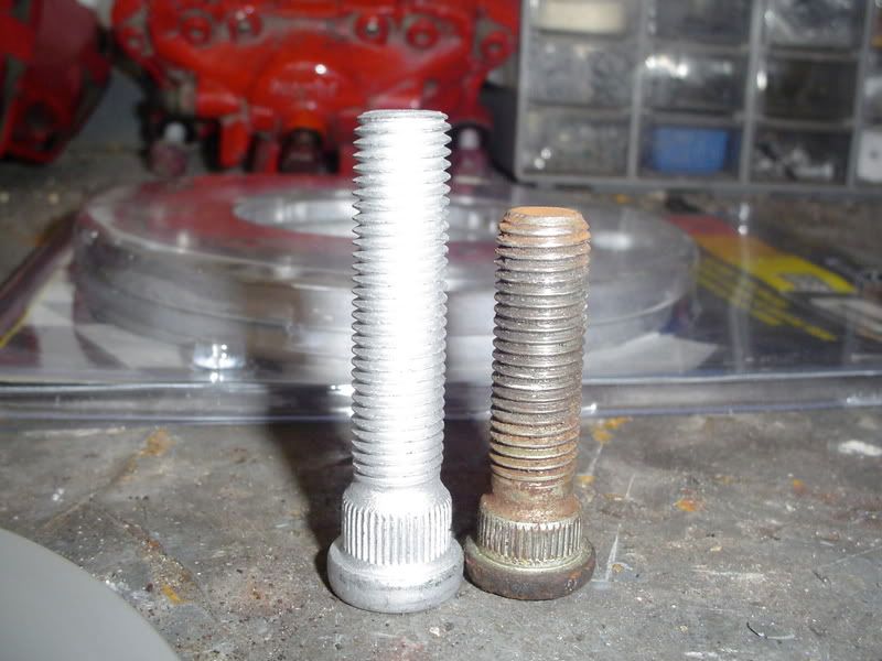

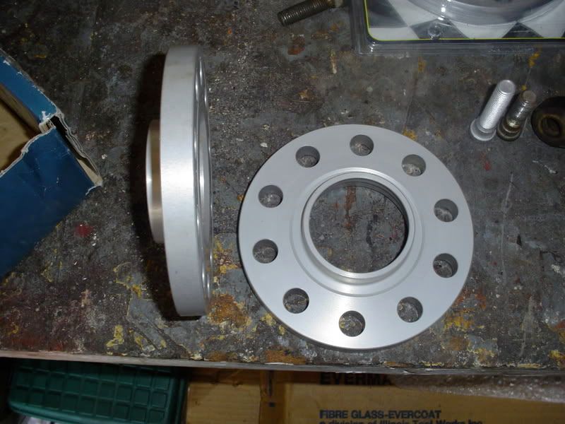

the H&R wheel spacers showed up today for the fronts
http://i122.photobucket.com/albums/o...o/DSC03795.jpg
stock 1g stud next to the H&R stud
http://i122.photobucket.com/albums/o...o/DSC03796.jpg
