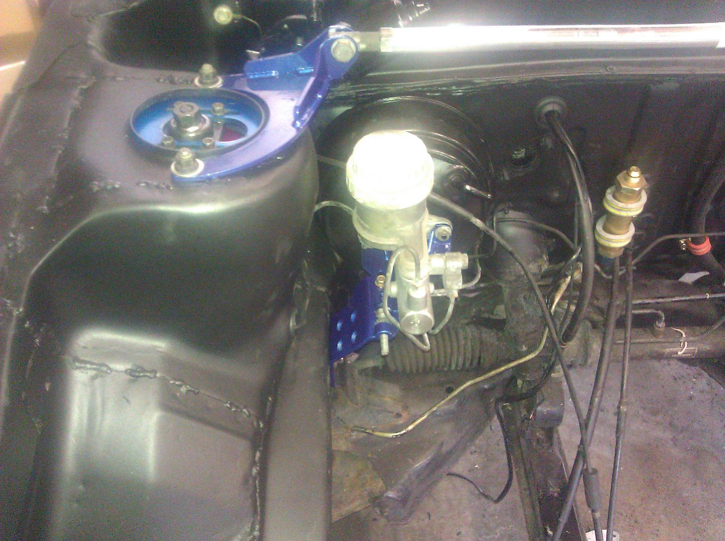

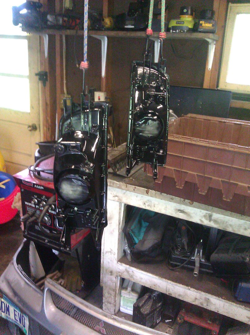

just got the first coat on looks so much better with just that so far. took a full can for the first coat to get it to cover now just have to do a few light coats then a few more heavy coats and let it fully dry then next weekend I can start wiring and putting it back together a bit
Halon 05-19-2011 04:56 PM
Re: the evo 3 swap parts are coming
Do those cans say rubber coating? Is it like bedliner kinda stuff?
TkrPerformance 05-19-2011 05:21 PM
it is a spray rubber it is what you put on tool handles. there are a ton of guys using it to paint there cars now. it you get tired of it you can just make a small cut in it and peal it right back off. but it will bond to anything out there. it does dry and is not rubbery. if you scratch it or gouge it just put more over the top the chemicals in it will melt into the older stuff and you will not see where it was at

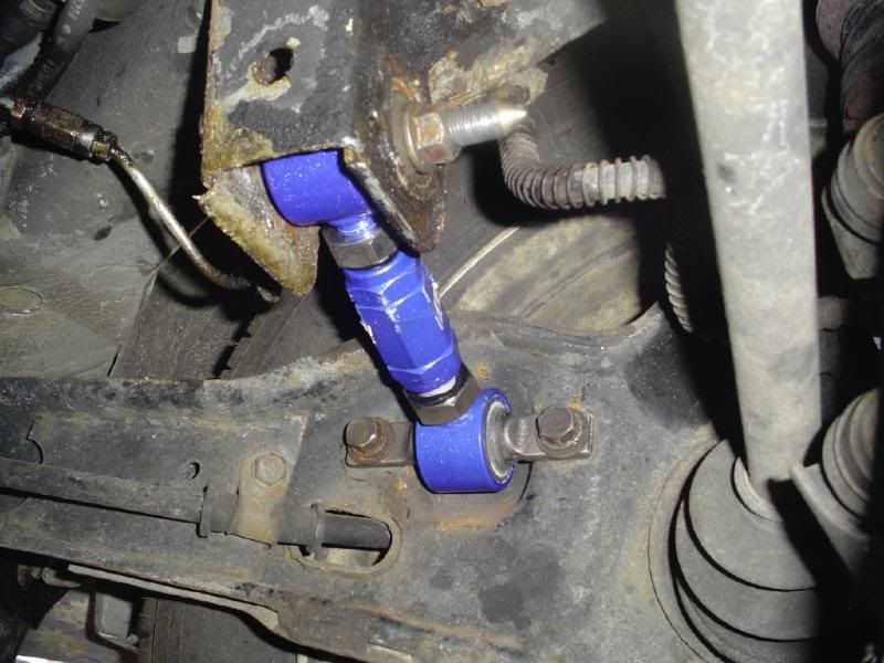

also we had a group buy on rear lower control arms for the mirages. they fit the evo rear end they just dont have a sway bar bracket on them but I will bring them to work and have big bird make me some and weld them to the arms
http://i172.photobucket.com/albums/w...1/IMG_3305.jpg
http://i172.photobucket.com/albums/w...1/IMG_3303.jpg
they just hit the states we got them from LLT-Racing out of Austraila

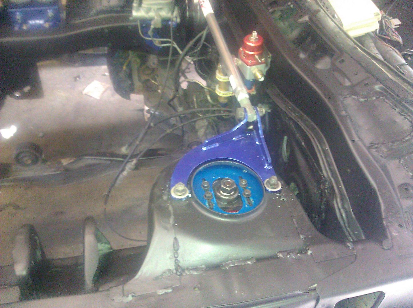

all painted up
http://i122.photobucket.com/albums/o...519_195424.jpg
http://i122.photobucket.com/albums/o...519_195503.jpg
http://i122.photobucket.com/albums/o...519_195512.jpg
http://i122.photobucket.com/albums/o...519_195525.jpg
http://i122.photobucket.com/albums/o...519_195540.jpg
http://i122.photobucket.com/albums/o...519_195555.jpg
http://i122.photobucket.com/albums/o...519_195606.jpg

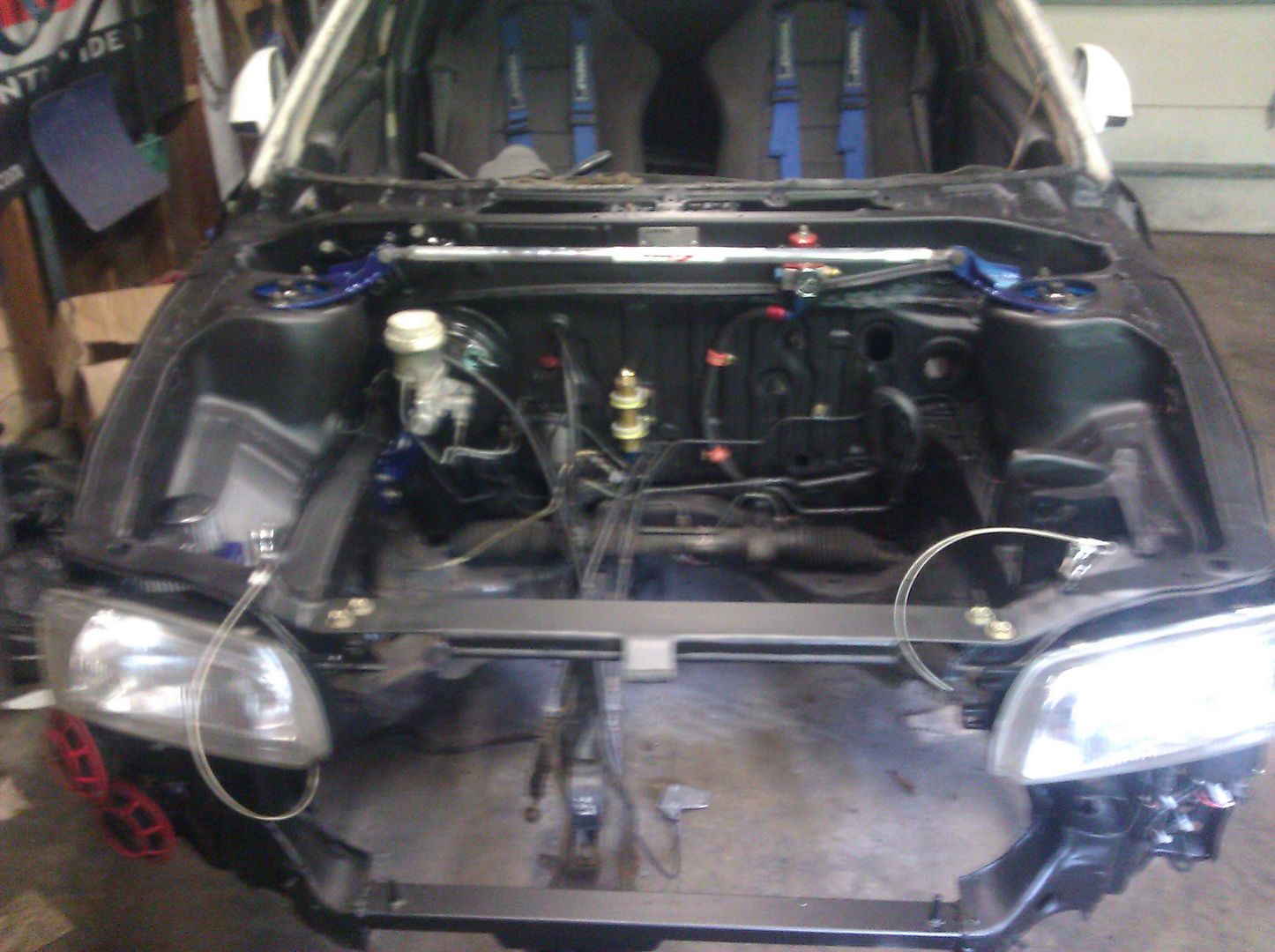

TkrPerformance 05-25-2011 07:37 PM

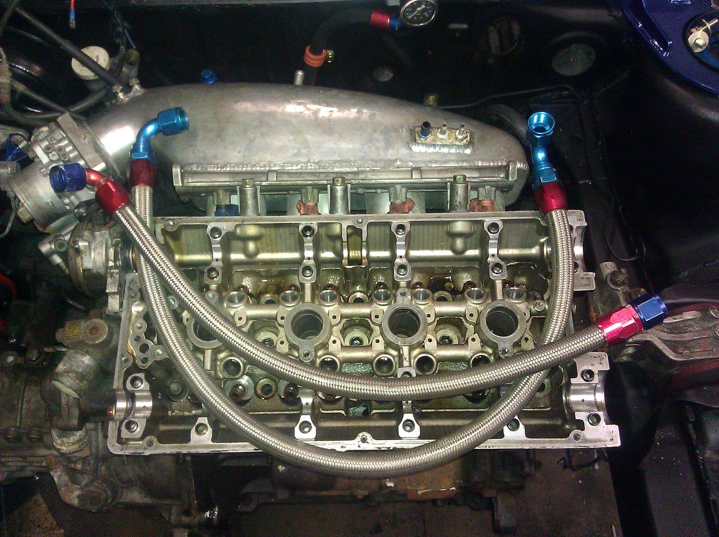

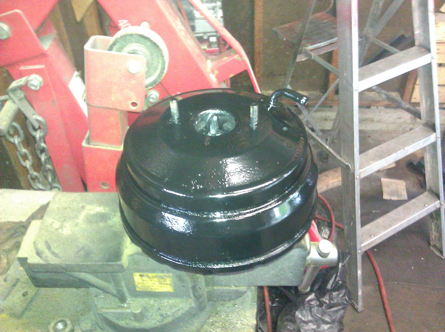

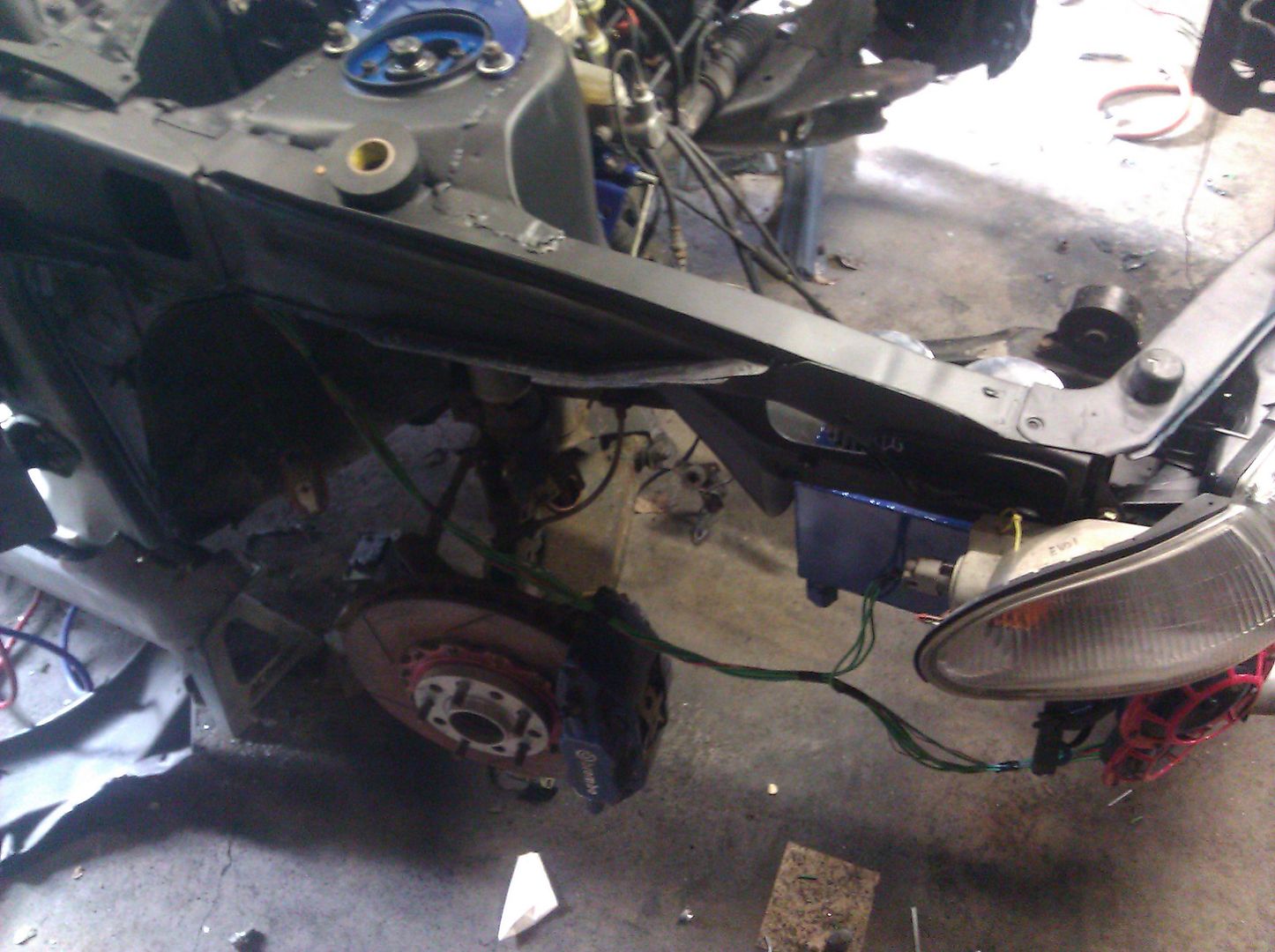

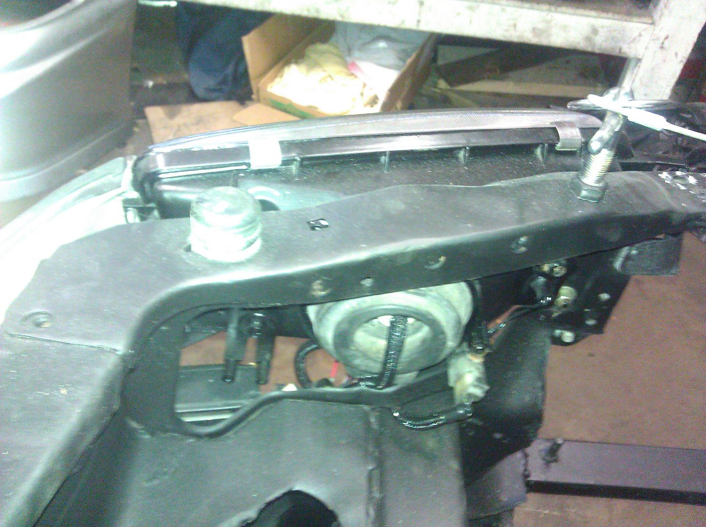

worked on the car put some of the stuff back in the engine bay. Cleaned the front cusco zero r2 coilovers and oiled the crap out of the camber plates. Use some of the fuel line holders that I brought home for the return line and the fuel filter. Also put the ce9a data plate in the car. I had the cd9a one from the evo 1 front clip. Got the hid boxs hidden and the hella super tones back on.
http://i122.photobucket.com/albums/o...525_173830.jpg
http://i122.photobucket.com/albums/o...525_172826.jpg
http://i122.photobucket.com/albums/o...525_172833.jpg
http://i122.photobucket.com/albums/o...525_172843.jpg
http://i122.photobucket.com/albums/o...525_172817.jpg
http://i122.photobucket.com/albums/o...525_172900.jpg
http://i122.photobucket.com/albums/o...525_172915.jpg
http://i122.photobucket.com/albums/o...525_173816.jpg
now I just have to wait for the ltt rear control arms to show up and all the braided nylon wire loom to get here

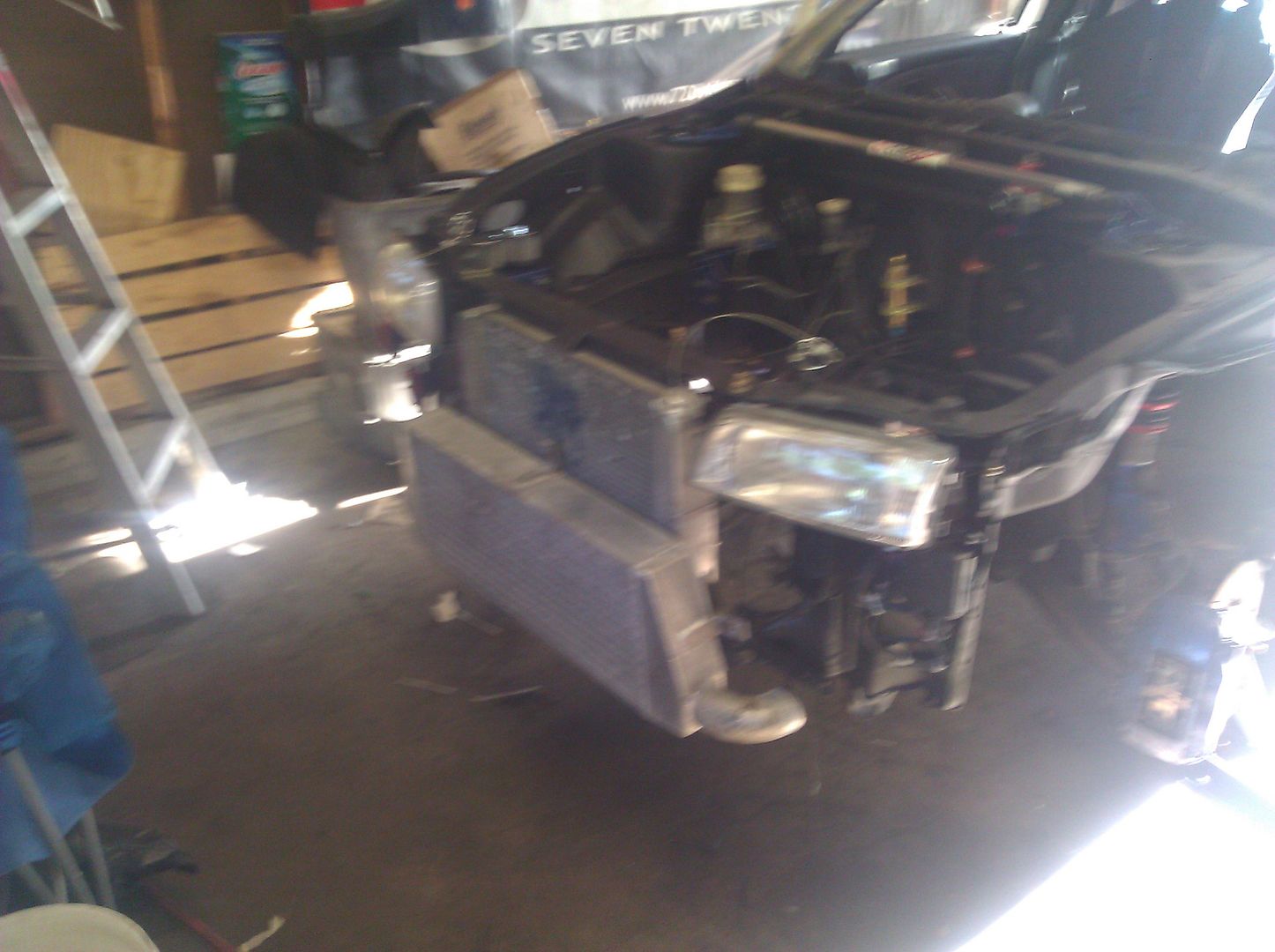

got the radiator in and bolted the fmic back on.
http://i122.photobucket.com/albums/o...526_182243.jpg
the wire loom was shipped out today so I will good to go next wed for the start of the rewire. also thinking of putting in a mock up engine and the tranny so I can do the engine harness so I can make every thing as short as I can

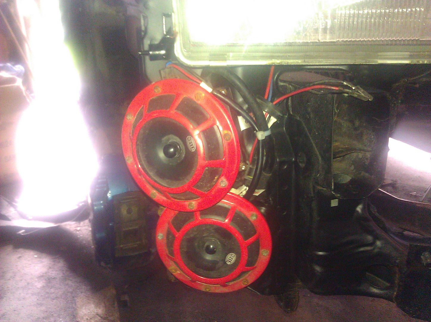

Halon 05-26-2011 09:54 PM
Pardon my ignorance, but what are those huge red ufo looking things?
TkrPerformance 05-26-2011 10:02 PM
they are hella super tone horns they are 118db

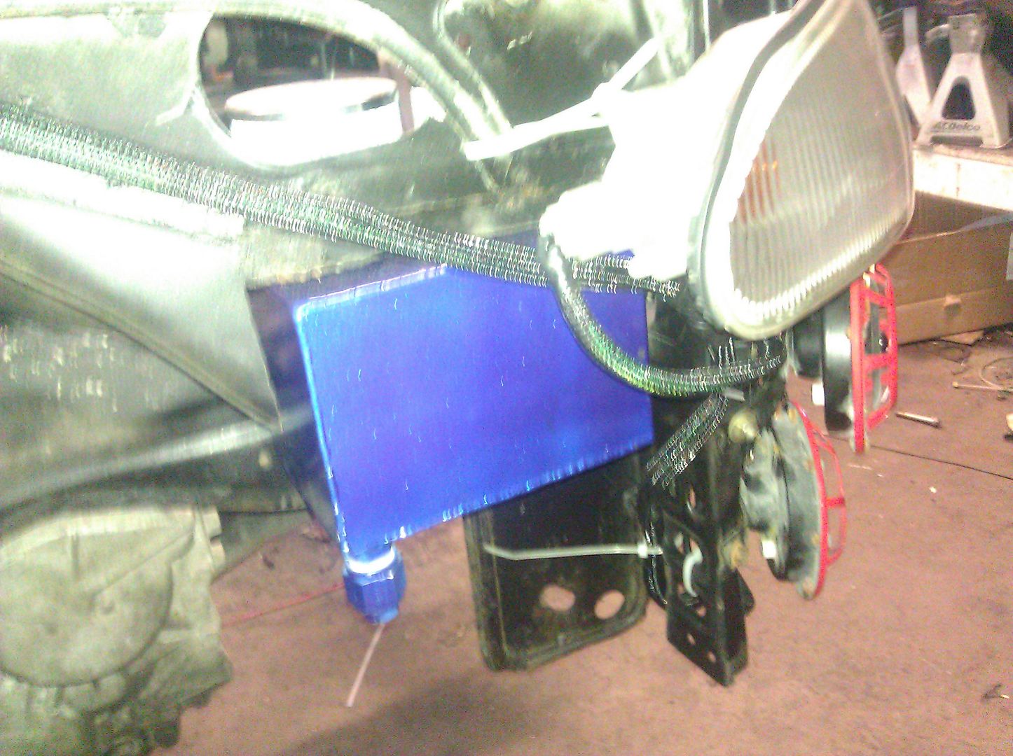

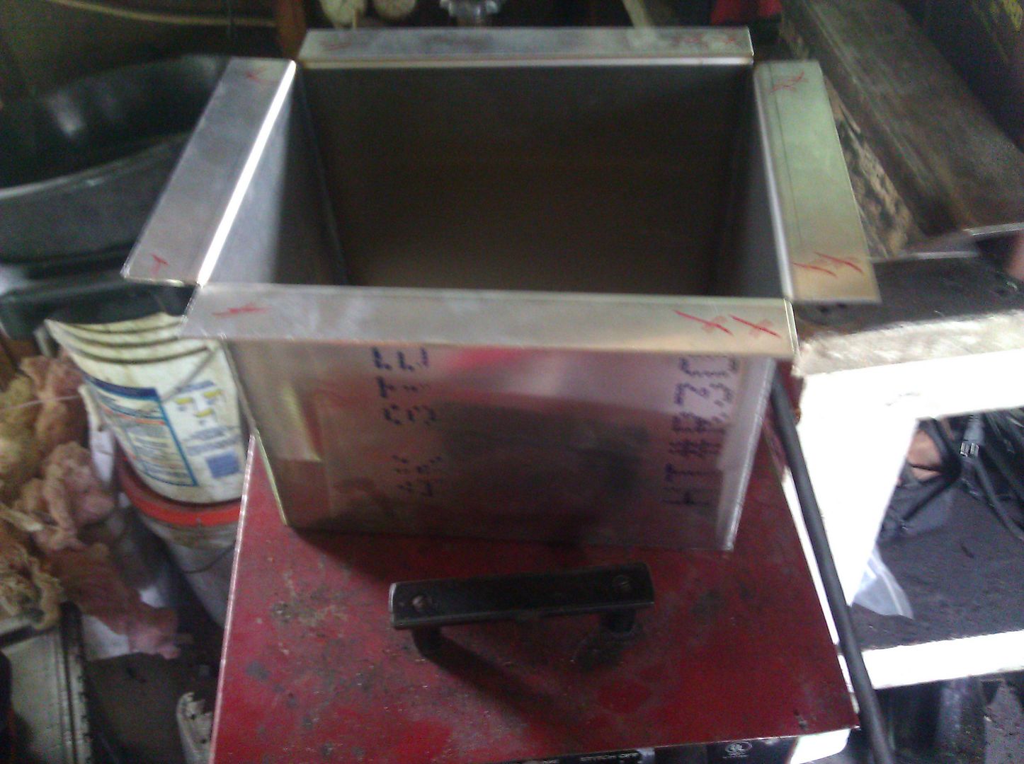

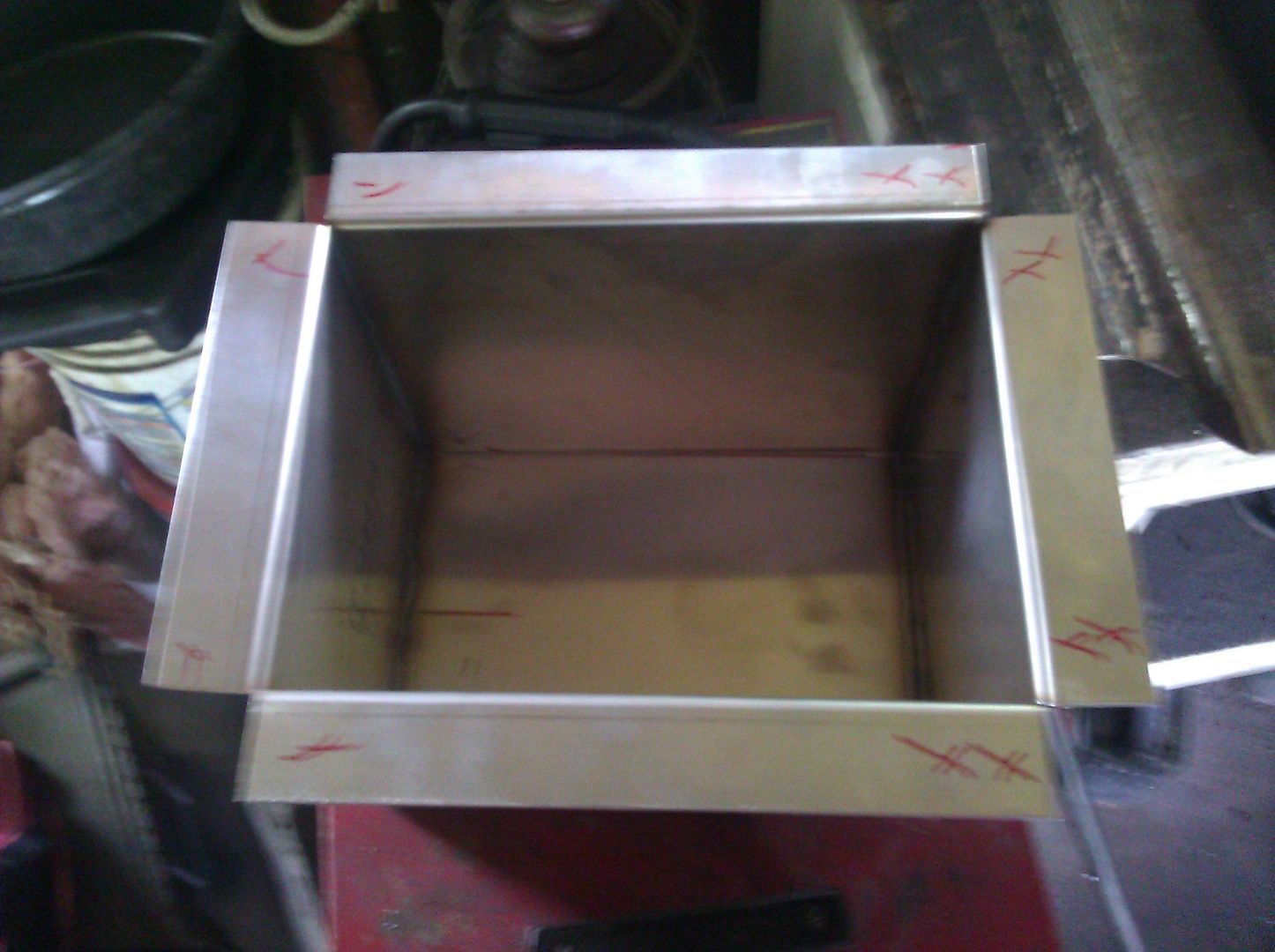

Got the new battery box made last night at work. It will hold a yellow top. The box it self is 304 1/2 hard s.s.
It will be going inbetween the frame rail and 1/4 panel on the right side of the trunk. It will be sunk in to floor and bolted in flush so the trunk will not loose any space
http://i122.photobucket.com/albums/o...530_111522.jpg
http://i122.photobucket.com/albums/o...530_111516.jpg

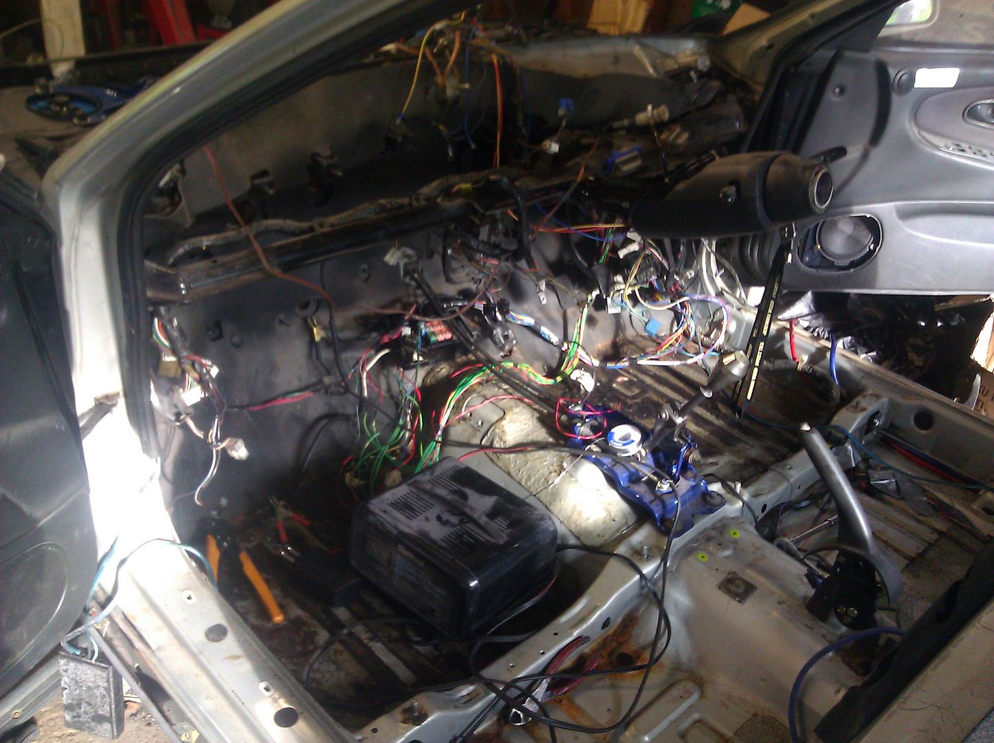

TkrPerformance 06-01-2011 09:47 PM

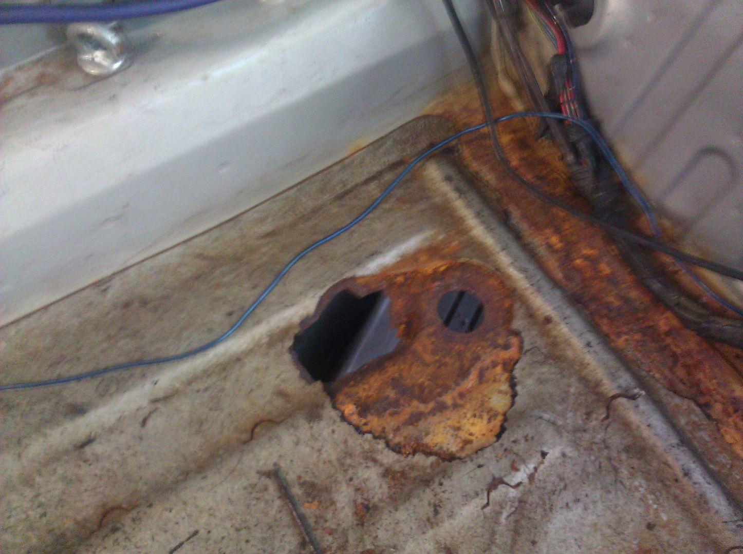

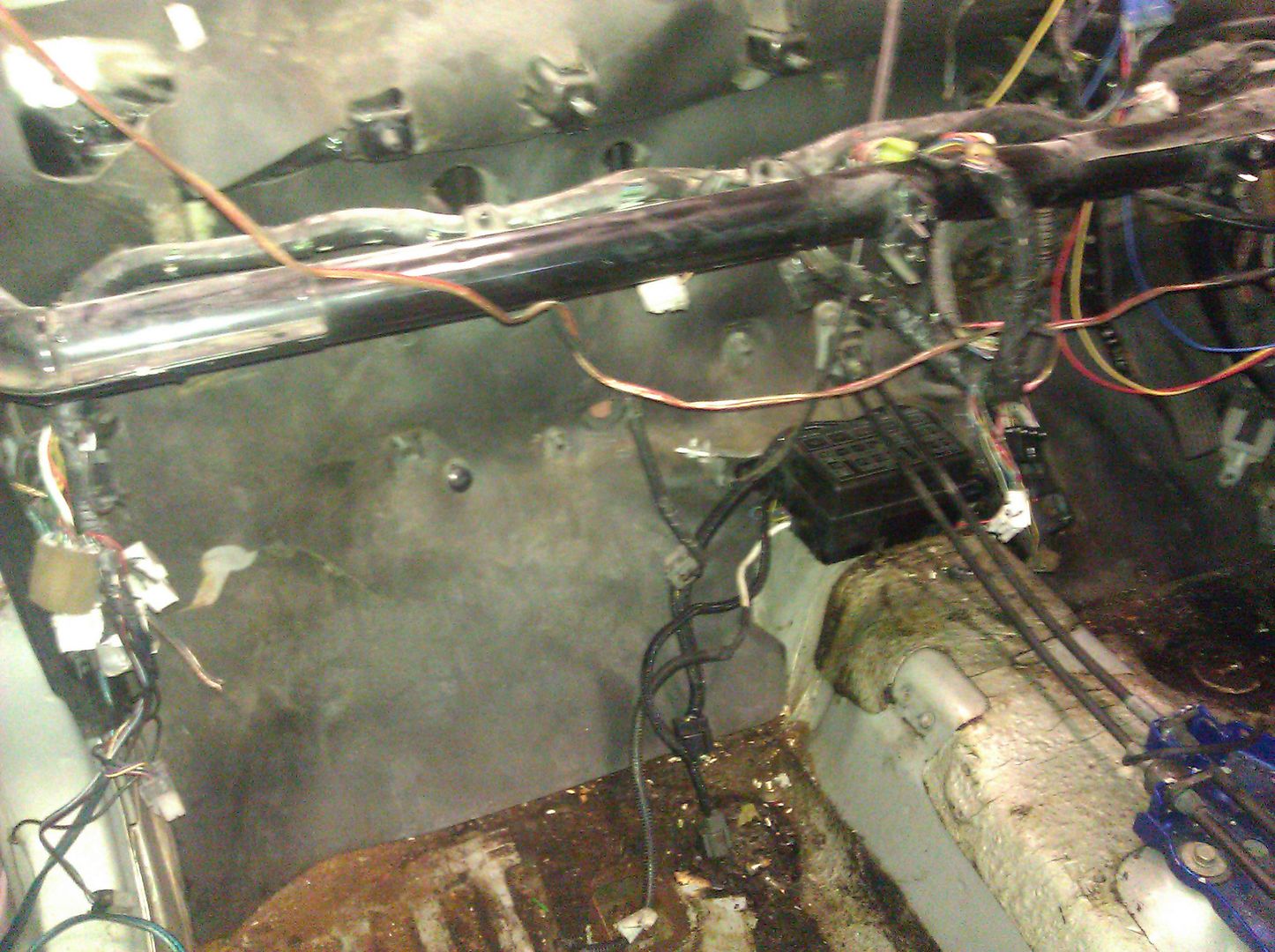

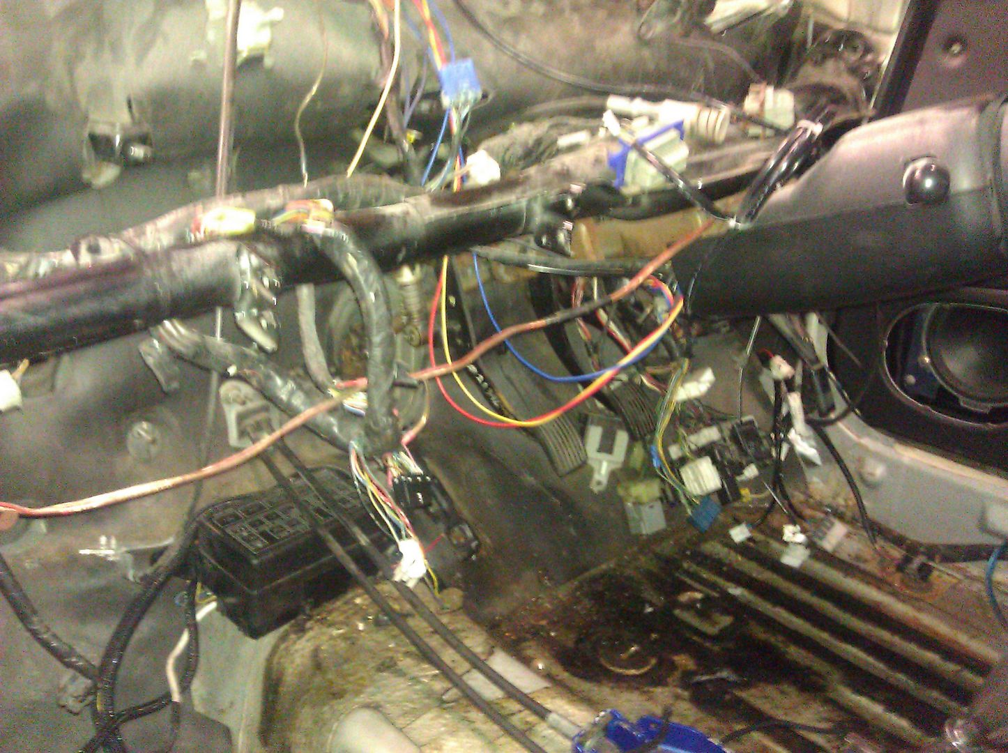

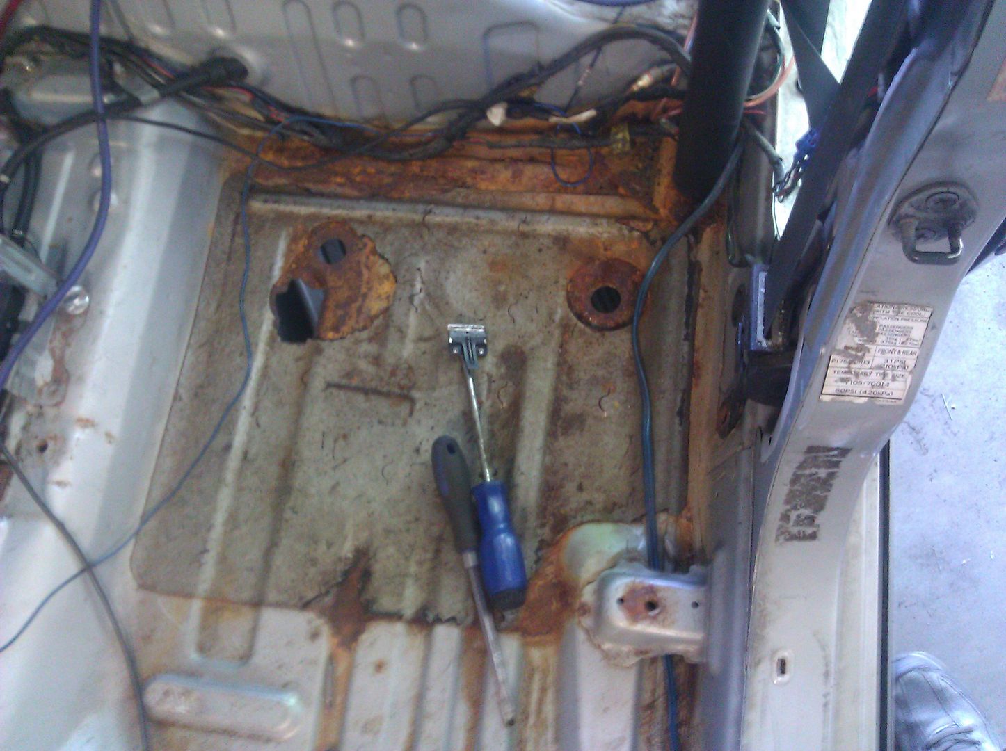

took out the seats and carpet and found this :( going to have to get some dry ice to get the sound deadner and fix the rust now.
http://i122.photobucket.com/albums/o...601_115807.jpg
http://i122.photobucket.com/albums/o...601_115759.jpg

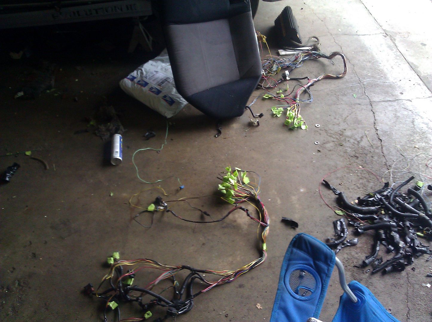

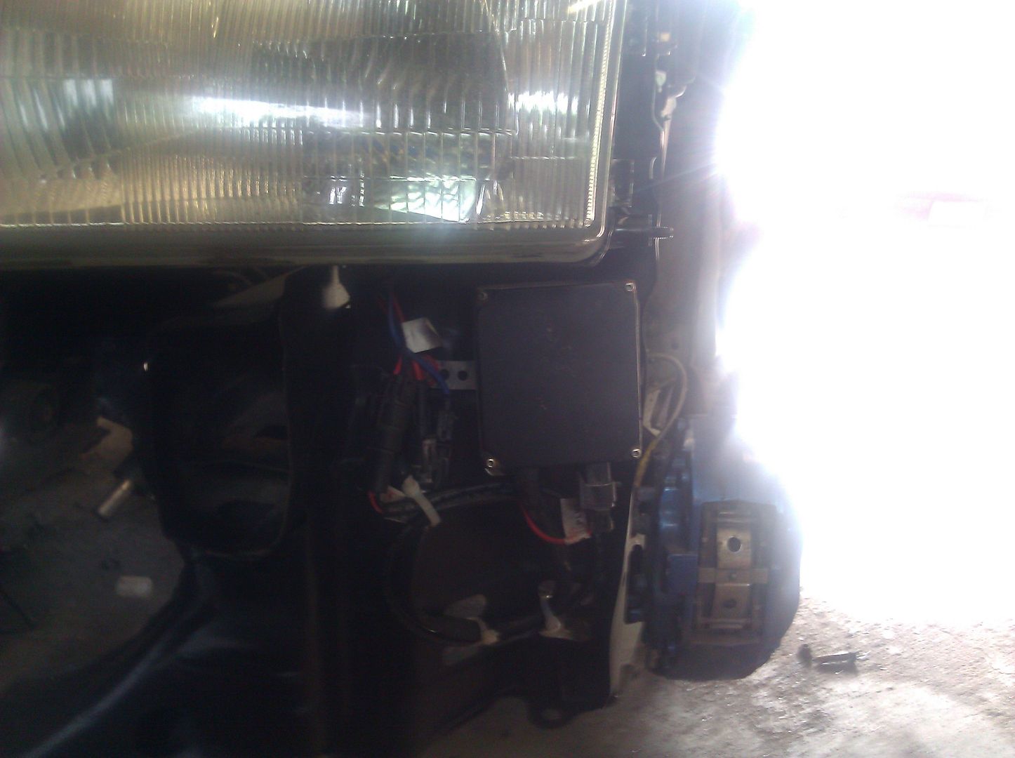

also rewired the engine bay. got it all hooked up and tested it out to make sure it all works and passed with flying colors
lest side just has a few wires that had to be extended
http://i122.photobucket.com/albums/o...601_182249.jpg
the right side all the wires needed to be extended into the car
http://i122.photobucket.com/albums/o...601_182300.jpg
where the fuse box is now going to sit. just have to make a bracket for it
http://i122.photobucket.com/albums/o...601_182311.jpg
tomorrow I will take it all back out and loom it all

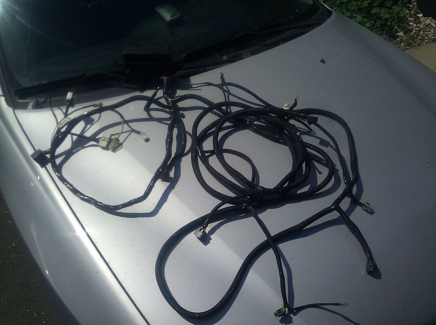

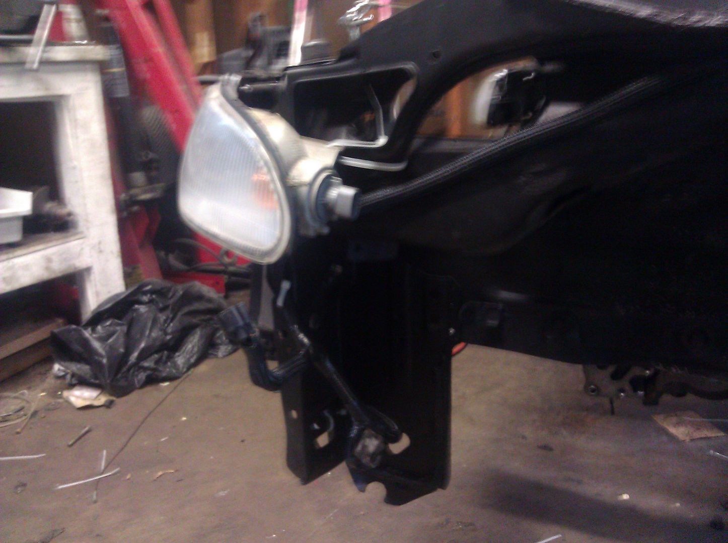

got it loomed today
http://i122.photobucket.com/albums/o...602_144801.jpg
back in all the wiring out of the fuse box is behind the firewall pad
http://i122.photobucket.com/albums/o...602_185539.jpg
just have to plug the wires in the the fuse box and put it back up were it goes
http://i122.photobucket.com/albums/o...602_185546.jpg
all the wiring back up were it ran to start with and all zipped tied down
http://i122.photobucket.com/albums/o...602_185422.jpg
http://i122.photobucket.com/albums/o...602_185428.jpg
http://i122.photobucket.com/albums/o...602_185447.jpg
http://i122.photobucket.com/albums/o...602_185453.jpg
all the wiring that is going to be in the engine bay from the engine bay harness. 2 sets of wires. 1 set for the city lights and 1 set for the hid lights

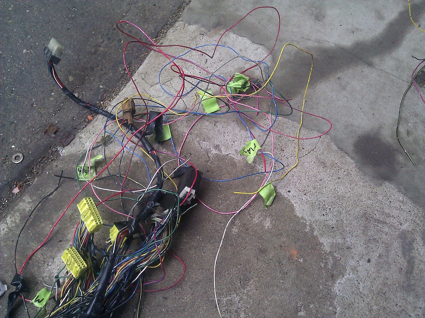

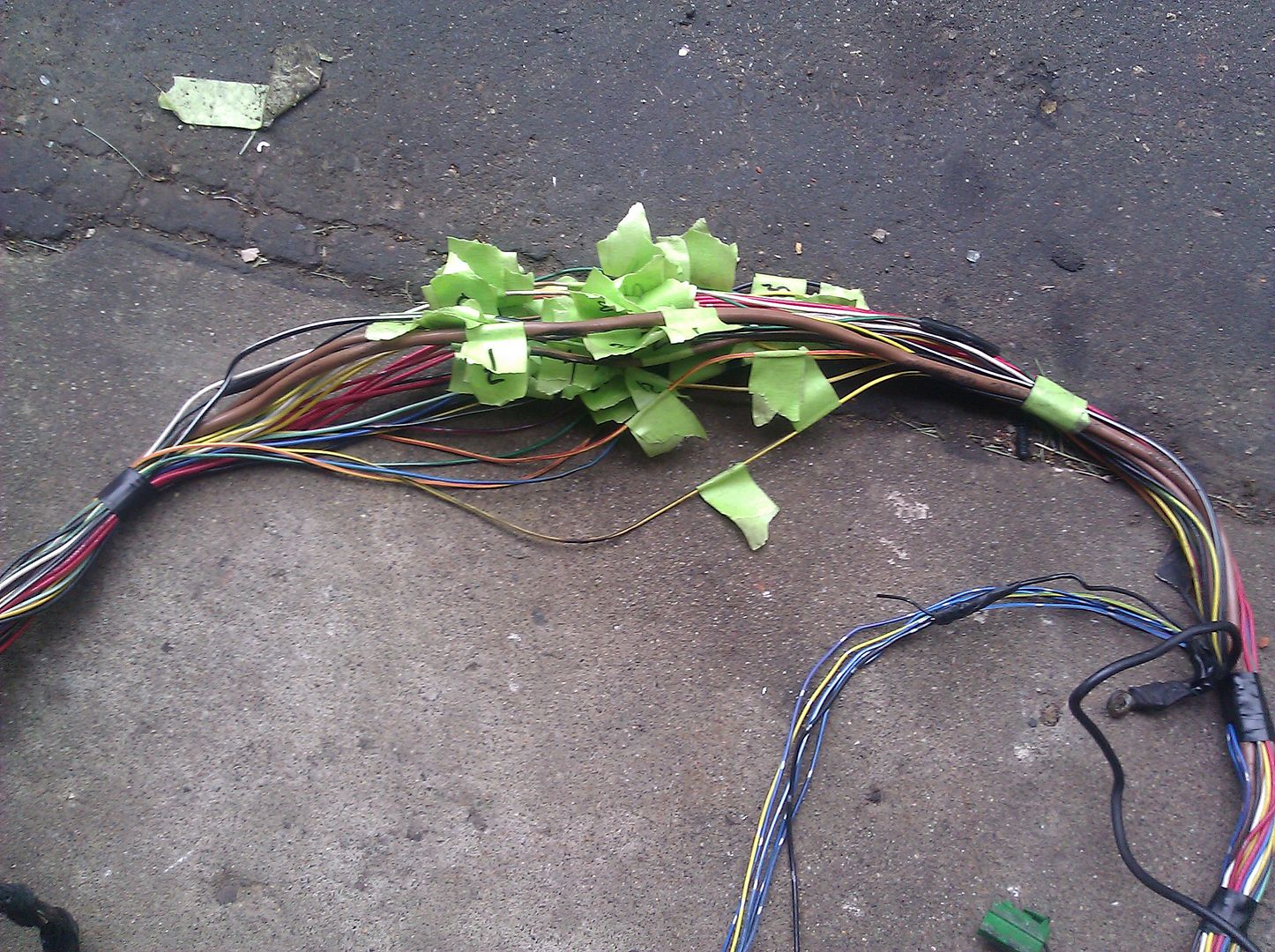

Started on the engine harness. Took out the 2 plugs that are not needed. Also moved the wiring for the mas and the plug for the fuse box to the in side of the car.
http://i122.photobucket.com/albums/o...603_120314.jpg
Marked and cut the harness in 1/2 to shorten it all up.
http://i122.photobucket.com/albums/o...603_120309.jpg
http://i122.photobucket.com/albums/o...603_123408.jpg

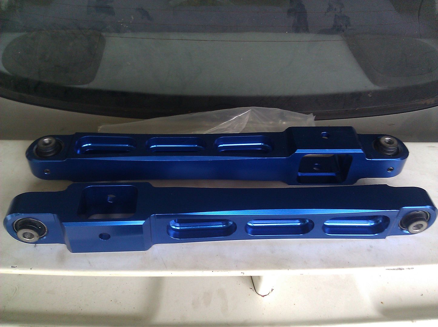

Also fedex droped of the new rear ltt lca's
http://i122.photobucket.com/albums/o...603_123641.jpg
