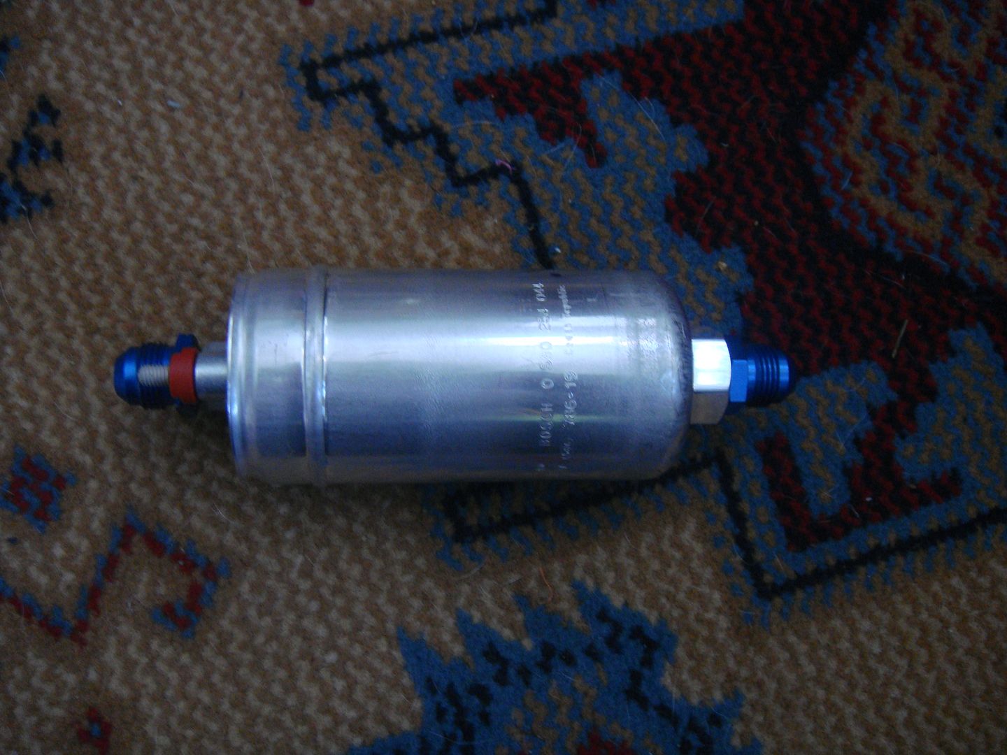

also just picked this up from shane today
http://i122.photobucket.com/albums/o...o/DSC01666.jpg

Nice cam gears!! Are you gonna have your 255 feed that Bosch 044 then or what? Thats what it is right?

that is what I will be doing is using the 255 to feed the 44. just need to pick up 2 push lock fittings and get it put in. then save up some more cash and off to Shane for a tune as it sits now
