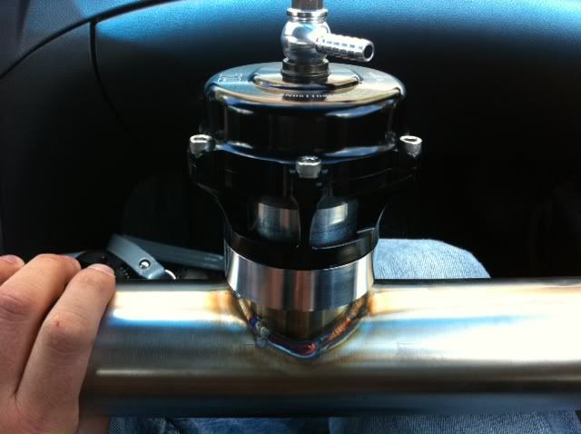

I got sick of the metallic Kttsssssssssttt the Greddy Type S BOV was making. So I bought and had MAP mount a Tial Q for me today. Unfortunately it still flutters on low boost so I'm going to try a dedicated vacuum source to see if it helps.

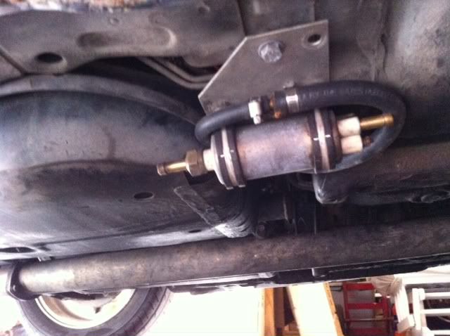

I decided to ditch the 255 intank / 255 inline setup also. I'm going to run two or three DW 300s instead. I have big plans for this car for next season and have started collecting parts. Including these Wiseco 7 bolt 10.5:1 HDs.
http://i269.photobucket.com/albums/j...g/photo-11.jpg

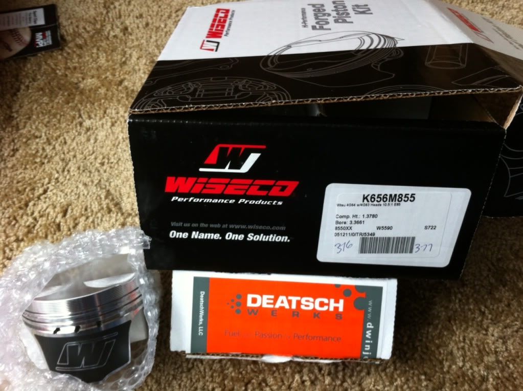

And no, the motor isn't 7 bolt. The Wiseco HD's were off the shelf 10.5:1 CR. If you look at the 6 bolt pistons they're only 8.5:1. Both pistons are the exact same dimensions omitting the CR and wrist pins. The 7 bolt pins are 1mm thicker than 6 bolts also. So I also get 1mm thicker wrist pins in 10.5:1 off the shelf (yes MAP had them in stock) at the cost of drilling out my rod bushings 1mm. :spin:

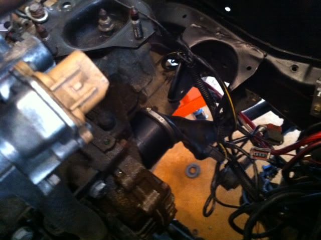

While poking around the car I found this, which I was told was hooked up:
http://i269.photobucket.com/albums/j...g/photo-12.jpg
And this:
http://i269.photobucket.com/albums/j...g/photo-13.jpg
Considering all of the I/C piping was also loose; I'm going to go over the whole car before it leaves the garage again.

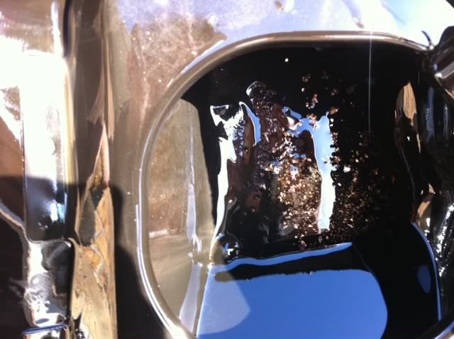

Anyway, here's what was in my oil pan.
http://i269.photobucket.com/albums/j...g/photo-14.jpg

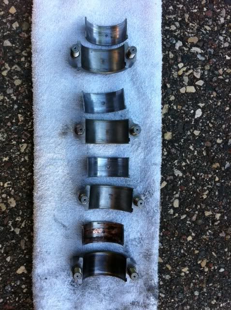

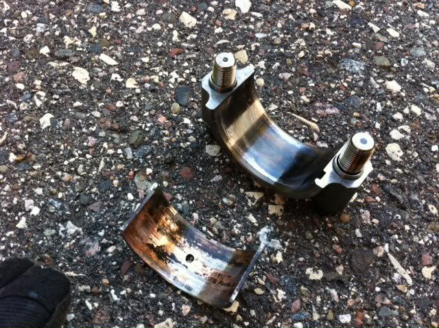

And I bet you can't guess which one was spinning haha.
http://i269.photobucket.com/albums/j...g/photo-16.jpg
http://i269.photobucket.com/albums/j...g/photo-15.jpg
Even though the bearing looks like it had a bad night in gitmo, the crank is surprisingly smooth. If the one rod wasn't blued from heat, I would throw another set of bearings in and see how it went.
I didn't have enough time to pull the motor out today but at least I know the situation now. The next decent day I'll get the motor out and send the rods out to be reconditioned and crank to be cut. Hopefully the crank doesn't need to go past .10 under. If it does, I won't be running it since DG Motors wants $180 to re-nitride it and who knows when I'd get it back. I have a nice OEM crank I picked up but I was trying to save it for the next build.
