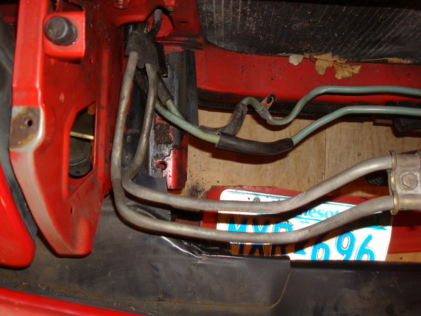

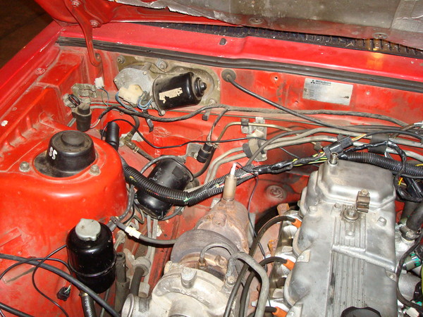

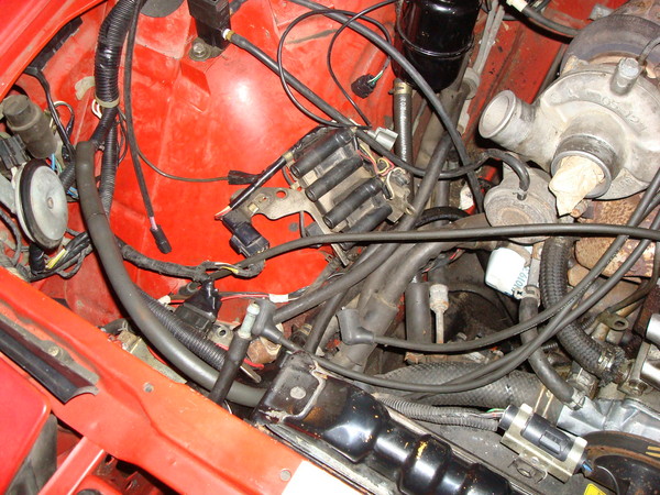

Here's some more pics as of friday. This is the new-ish setup for wiring. I bought some new split loom tubing for all this, so it'll be cleaned up more, but I re-routed the ignition wires and stuff to go through the secret passage above the wheel well.
http://www.mitsustyle.com/photopost/...m/DSC01468.JPG
This is where the stock engine harness came through. Now it's the knock and O2 sensors and the coil pack and transistor plugs.
http://www.mitsustyle.com/photopost/...m/DSC01469.JPG
And here's the location of the stuff.
http://www.mitsustyle.com/photopost/...m/DSC01467.JPG

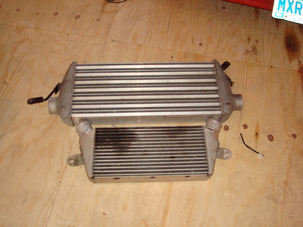

Happy birthday to me. Apexi GT core. It's damn huge. I hugisized it for 79 cents.
http://www.mitsustyle.com/photopost/...m/DSC01480.JPG

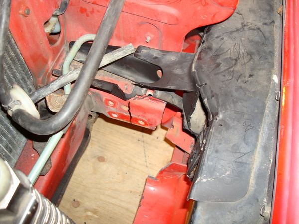

I have to cut the bumper supports quite a bit, and I can't really do that in this warehouse I'm in (I think) so that install might have to wait. then I'm getting some Al. pipes, I'll need a bov, the new manifold (yet to buy) and the exhaust welded up and it should be all done mechanically by then.

Here are the latest pics, I cut away a good section of the bumper to make way for the ginormous intercooler pictured above. I think it'll be ok for the time being, I plan on having it re-inforced later, once the car is running. Next I have to cut the frame rails to match the removed section of the bumper supports. Who needs collision protection anyway, right?
