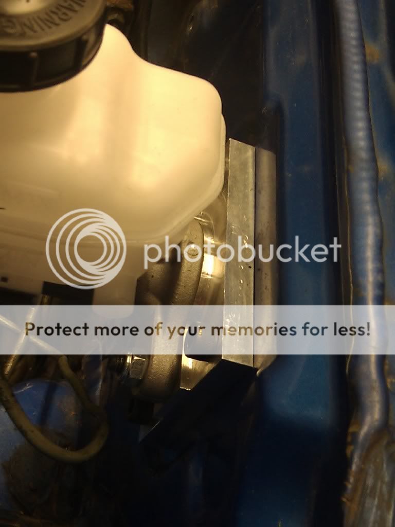

I played around with my mill and lathe yesterday and completed the adaptor bracket for the master cylinder.

mondale 12-28-2012 06:56 PM
Re: Mark's 1G Winter Projects
What master cylinder are you using now?
goodhart 12-29-2012 12:05 PM
How much extra effort will this add to braking? It would be sweet to ditch that giant thing out of the engine bay, any guess on weight savings?

Mark Leasure 12-30-2012 12:45 AM
I need to give credit to a thread on EvoM for finding the part number:
http://forums.evolutionm.net/welding...-delete-2.html
This is the one I used, has a 7/8" cylinder:
Centric 130.46522
http://www.rockauto.com/catalog/moreinfo.php?pk=1626166
Mark Leasure 12-30-2012 12:48 AM
I don't know but I'm sure it will be fine. Others have reported that it works good on track cars. Total weight savings is in the neighborhood of 8-10 lbs. It's nice having extra room in the engine bay.

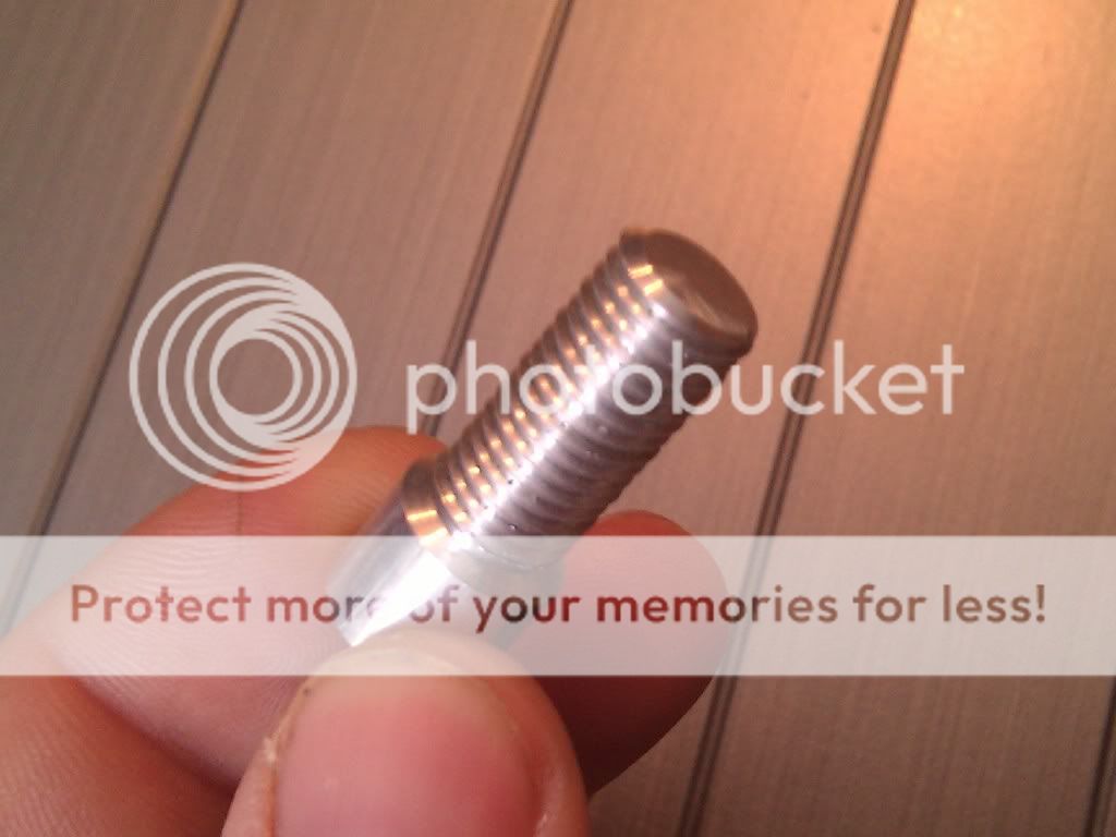

You should have seen some of the hack work I had performed on my talon back in the day! I love this hobby since I’m always learning better techniques on just about everything. I enjoy fabricating and building stuff. I didn't use a CNC on this one, I used my manual mill. I’ve been building my tool collection for a while now. I still have so much to learn, I'm glad I can find just about any tutorial on YouTube. For instance I just figured out how to cut threads on my lathe. I needed to make a new rod to actuate the master cylinder, I practiced on a piece of aluminum.

goodhart 12-30-2012 01:46 AM
That is cool as hell man. It would be nice to clear up all that space in the bay though, makes me want to do it to the beater some day.
also- that EvoM link is pretty damn interesting, learned lots of things I never knew about brakes!

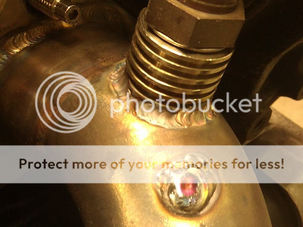

I installed my per cylinder widebands today.
http://i412.photobucket.com/albums/p...230_114537.jpg
http://i412.photobucket.com/albums/p...230_114942.jpg
I also noticed that I had a huge crack on the inside of my turbo exhaust housing. I found a Honda guy that had a new 1.15ar for sale, so I bought it.
