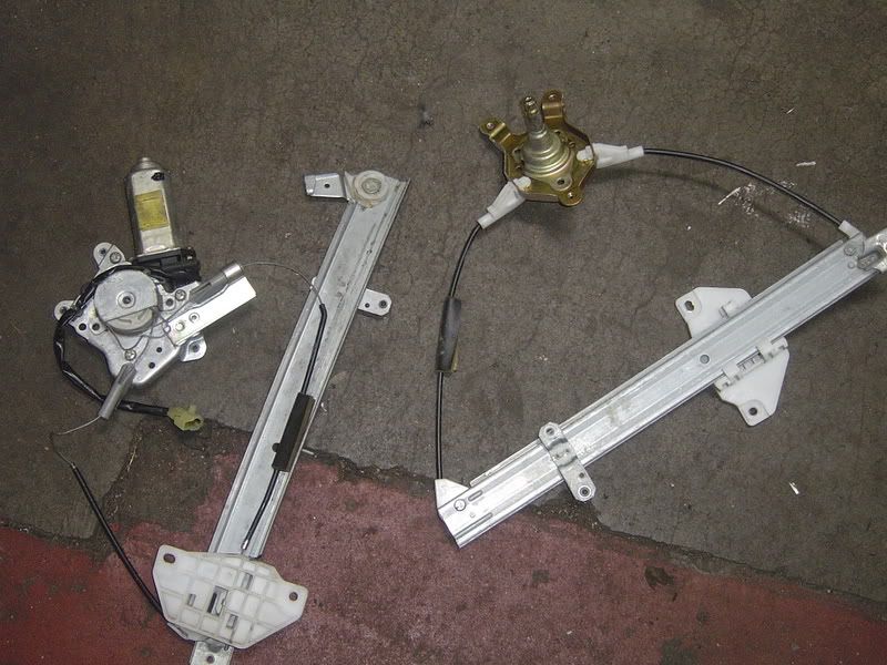

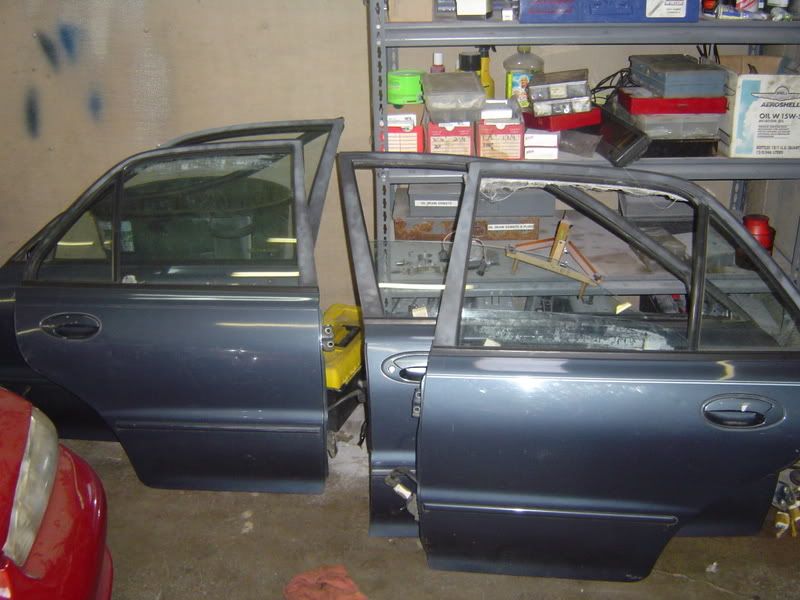

went to u pull it on tue and got a set of 93 mirage power doors from a canada mirage, also got the trunk side carpet and plastic panel, it also had the evo rear reflectiors in it. Would have piced up the roof skin also but had a rust hole all the way though so I am still looking for one.
http://i122.photobucket.com/albums/o...evo/evo012.jpg
3 of the 4 doors had the windows taped shut and this is why. the cables were broken on the power regulators. So took out my manuel regluators cut them apart and used the cables and track for the power regulators.
http://i122.photobucket.com/albums/o...evo/evo015.jpg

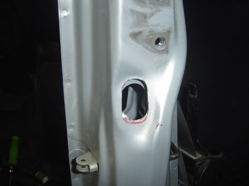

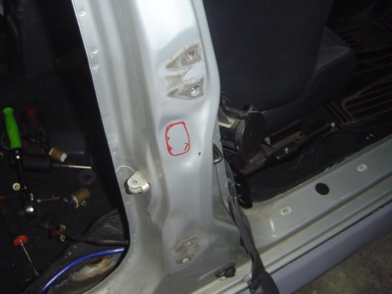

marking out the hole and cutting it for the wires to go into the car for the power
http://i122.photobucket.com/albums/o...evo/evo013.jpg
http://i122.photobucket.com/albums/o...evo/evo014.jpg

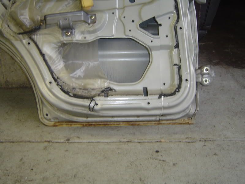

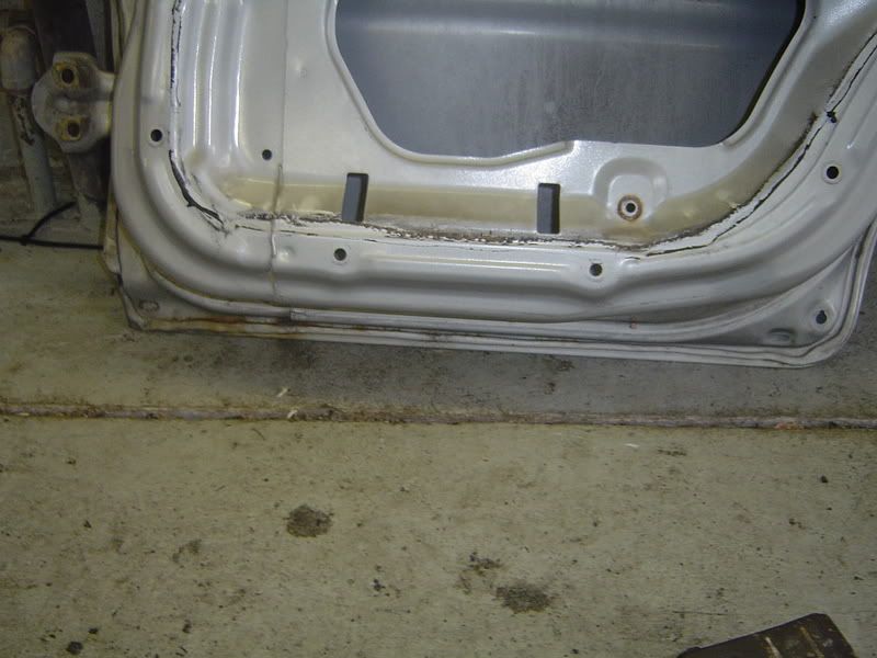

here is why they are getting replaced
http://i122.photobucket.com/albums/o...evo/evo019.jpg
http://i122.photobucket.com/albums/o...evo/evo020.jpg
I can fix the dents in the new doors but it is not worth it trying to fix the rust on the bottom of the doors that were on the car

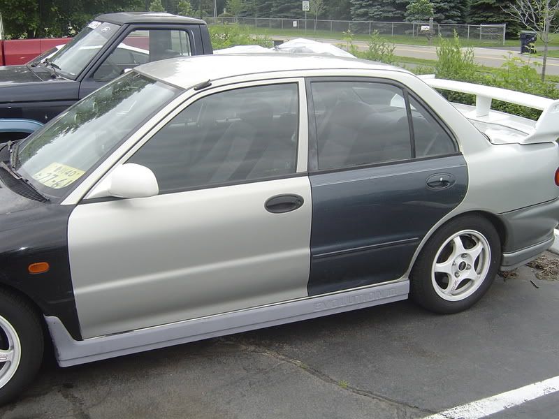

TkrPerformance 06-07-2007 10:08 AM
Re: the evo 3 swap parts are coming

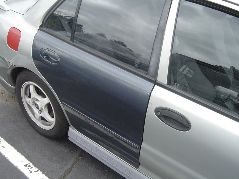

got the rear doors on the car I now have 7 colors on the car right now
silver,black,white,dark blue,red,primer grey,stock color
http://i122.photobucket.com/albums/o...evo/evo016.jpg
http://i122.photobucket.com/albums/o...evo/evo018.jpg

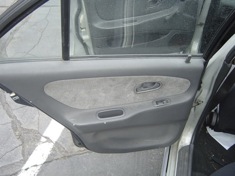

the inside panel
http://i122.photobucket.com/albums/o...evo/evo017.jpg
