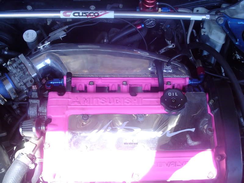

TkrPerformance 08-17-2008 01:49 PM
Re: the evo 3 swap parts are coming
kevin and I got the 8an fuel lines in the car yesterday and finnished this morring. I taped the rail 8an by 3/8npt and brandon powder coated it hot pink to match the valve cover.

FattyBoomBatty 08-17-2008 07:08 PM
I know pink is interesting because it's different, but I'm going to go ahead and recommend you stop where you're at. ;)

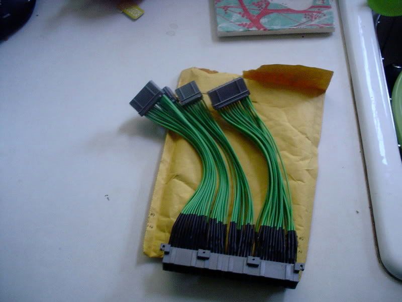

TkrPerformance 08-26-2008 06:17 PM
got the evo 8 patch harness today now I just have to find a deal on a evo 8 ecu
http://i122.photobucket.com/albums/o...o/DSC04601.jpg

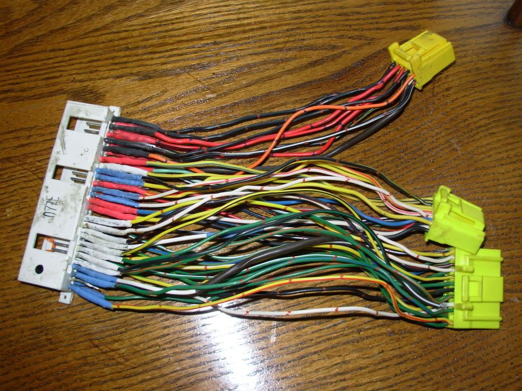

Andrew7dg 08-27-2008 08:28 PM
Hmm... That looks a lot like the one I just built except yours is cleaner
http://i217.photobucket.com/albums/c...g/DSCN1910.jpgEvo 8 Ecu? Does the evo 3 and evo 8 match?
TkrPerformance 08-28-2008 09:40 AM
the evo 3 harness is just like a 2g/evo 8 but is obd1 and is missing the 4th plug. So I just have to swap wires on the patch harness wire the 4th plug in and the obd2 plug. I have them extra from the 2nd set of harness for the spyder
