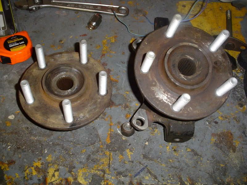

the H&R wheel spacers showed up today for the fronts
http://i122.photobucket.com/albums/o...o/DSC03795.jpg
stock 1g stud next to the H&R stud
http://i122.photobucket.com/albums/o...o/DSC03796.jpg

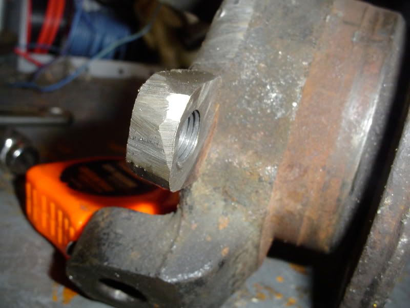

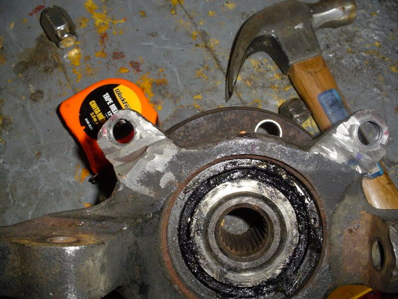

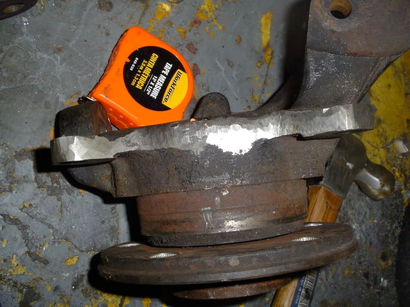

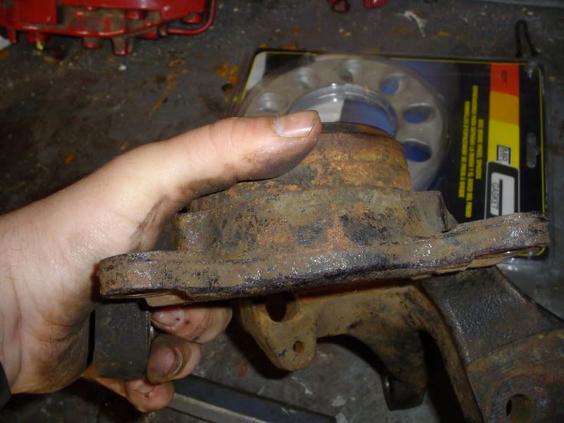

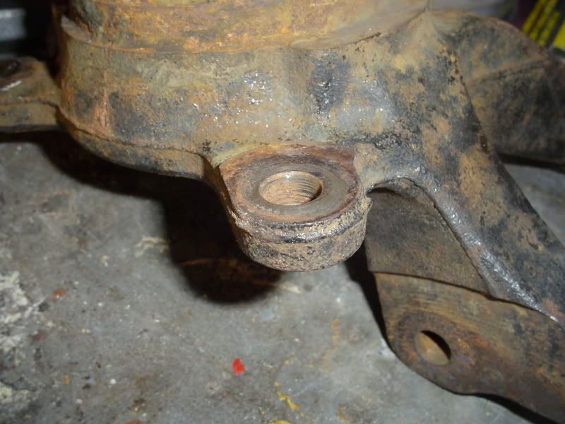

TkrPerformance 05-21-2008 09:31 PM
Re: the evo 3 swap parts are coming

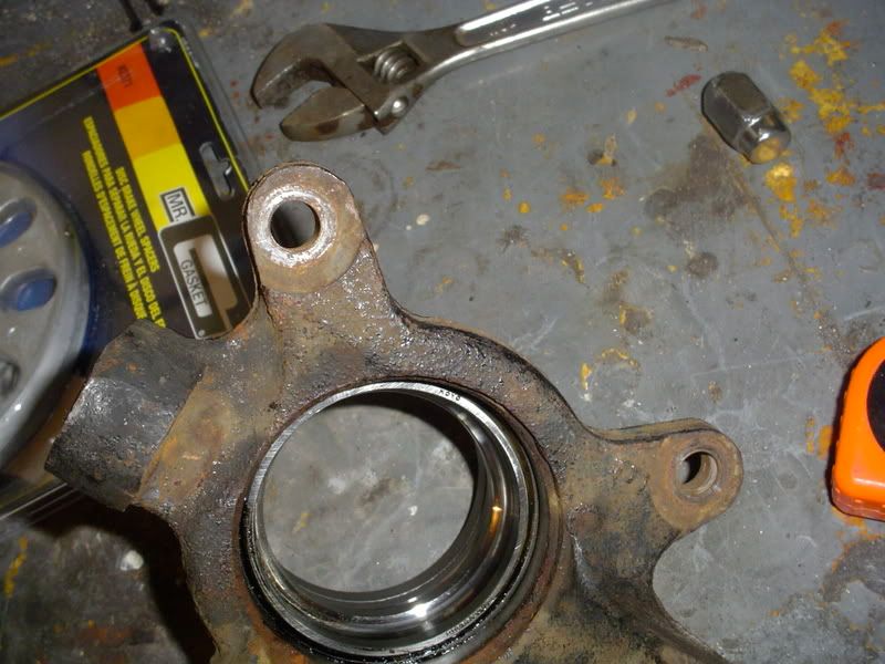

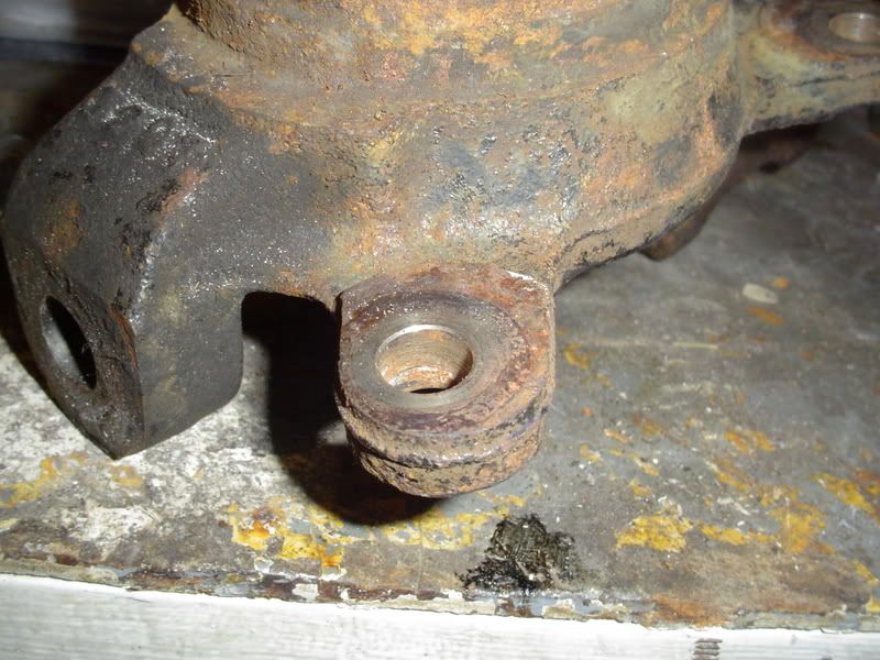

here is some more
pics of the other knuckle and the one that has been ground down to make the brembo brackets fit. Pic was before I did the final clean up on it and did the other knuckle.
http://i122.photobucket.com/albums/o...o/DSC03800.jpg
http://i122.photobucket.com/albums/o...o/DSC03801.jpg
http://i122.photobucket.com/albums/o...o/DSC03806.jpg
http://i122.photobucket.com/albums/o...o/DSC03807.jpg
TkrPerformance 05-21-2008 09:34 PM
with all the clearness for the brackets first knuckle I did before final clean up
http://i122.photobucket.com/albums/o...o/DSC03802.jpg
http://i122.photobucket.com/albums/o...o/DSC03803.jpg
http://i122.photobucket.com/albums/o...o/DSC03804.jpg
http://i122.photobucket.com/albums/o...o/DSC03805.jpg

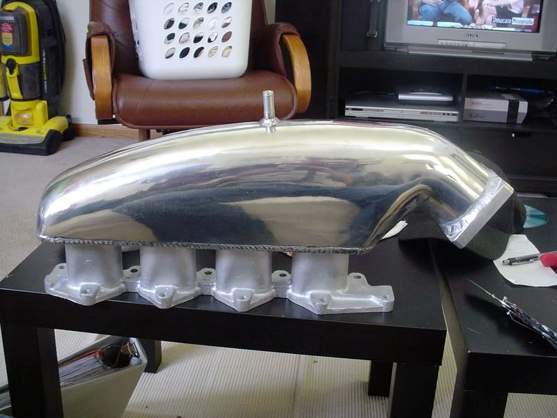

TkrPerformance 05-22-2008 11:12 AM
the smim just showed up
http://i122.photobucket.com/albums/o...o/DSC03809.jpg
http://i122.photobucket.com/albums/o...o/DSC03810.jpg
http://i122.photobucket.com/albums/o...o/DSC03812.jpg

DSM_421 05-22-2008 03:20 PM
How much did you pay for that thing if you don't mind me asking.
123abc 05-22-2008 03:25 PM
That smim is a work of art.
Kevin 1G Drummer 05-22-2008 05:46 PM
For a knockoff, that's pretty damn nice!
TkrPerformance 05-22-2008 09:25 PM
it is a copy of a hks smim I got it for 250.00 +139.00 for shipping from japan on a great buy they are now up to 480.00+the shipping cost

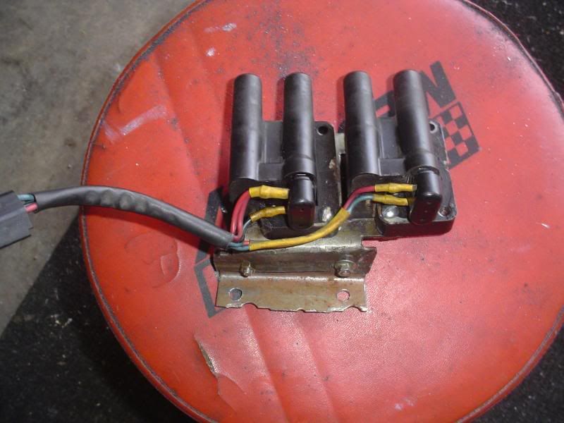

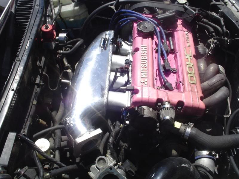

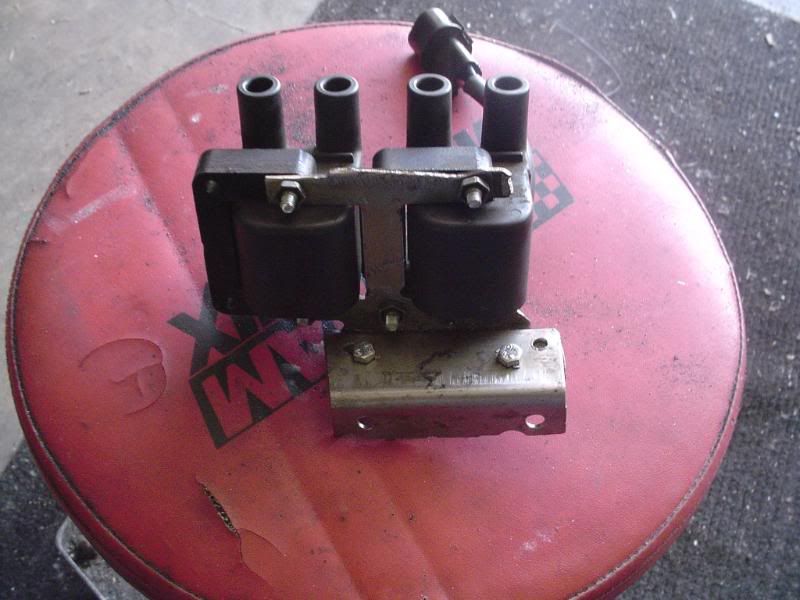

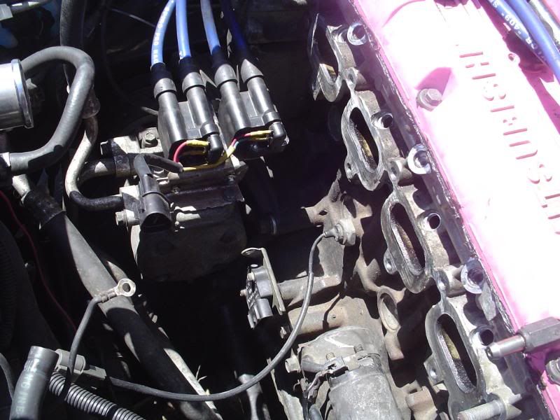

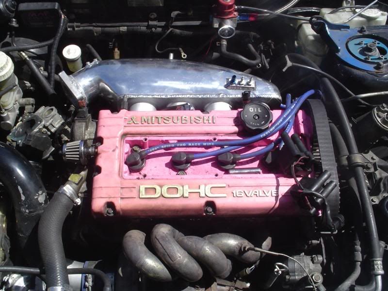

TkrPerformance 05-22-2008 09:35 PM

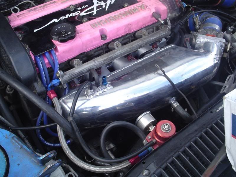

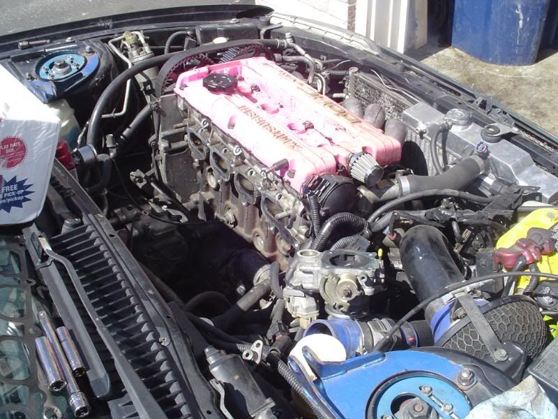

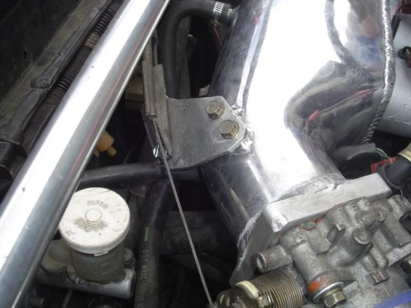

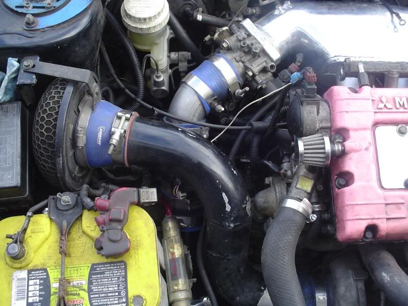

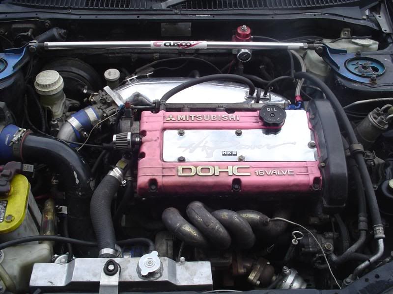

I have to thank my dad Ken for doing the coil pack bracket. he made it from a extra 90 dsm coil bracket and some angel iron I had at the house. it is now mounted on to of the A/C pump. I also drilled out the mount hole on a 91+ ignitor and put it were the oem intake bracket was. Dad also made an alum bracket to move the throttle cable so it would work and not bind up. We did a mini wire tuck also. I just have to get a longer hose for the PVC. We also had to redo the fmic piping with a 45 bend and cut the lower pipe shorter. On the smim we had to drill out the bolt holes a bit to get it to fit the bigger studs. But that was the only thing we had to do to it.
now to the pics
http://i122.photobucket.com/albums/o...ictures001.jpg
http://i122.photobucket.com/albums/o...ictures006.jpg
http://i122.photobucket.com/albums/o...ictures007.jpg
http://i122.photobucket.com/albums/o...ictures008.jpg

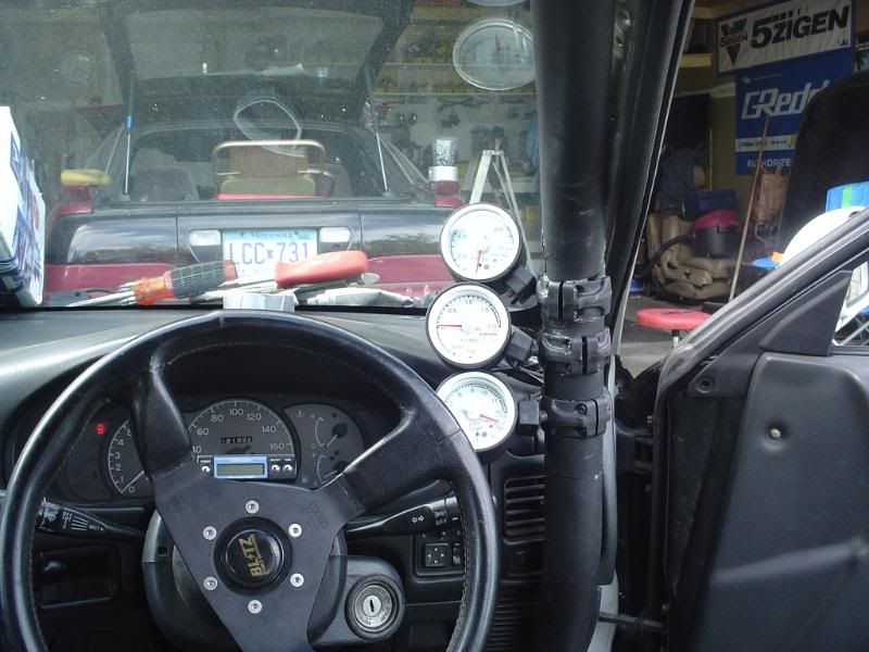

also got the autometer cage mounts and got them installed also and cut the cage foam out to put them in and used some 3m spray glue and trimmed the foam to fit back on it all
http://i122.photobucket.com/albums/o...ictures011.jpg
http://i122.photobucket.com/albums/o...ictures012.jpg
