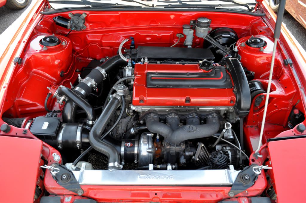

Here is a pic of everything installed. Eventually I'll redue the UICP since it's really janky right now.
http://i224.photobucket.com/albums/d...er2010/bay.jpg

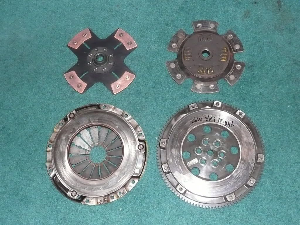

I let the car sit for about a month since I was so sick of it until one day it hit me that the cookout was coming up and I didnt want to miss it. So I picked up a '90 tranny from Cudvig. A new ClutchNet solid 4-puck disk, resurfaced the flywheel and freshened up the ACT2600 PP surface.
http://i224.photobucket.com/albums/d...0/P1040099.jpg
Got the car running and tranny shifts decent except for 2nd gear. I have to really granny shift it so it doesn't grind. But the tranny was cheap so I couldn't complain. I drove the car to work and back a couple days and everything was fine. I detailed the car and the colt wednesday before the cookout and the car was looking better then ever. On the way to the cookout the car decided to hate me and I blew 4 fuses on the way.. Thank god a fuse didn't blow once we hit traffic. That would have been a nightmare. But I made it there and back and that's all I wanted out of the car this summer.

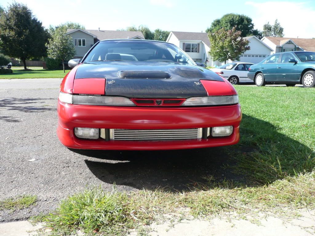

Oh and I did a little photoshoot. Here are a couple pics.
http://i224.photobucket.com/albums/d...0/P1030947.jpg
http://i224.photobucket.com/albums/d...1030973HDR.jpg
http://i224.photobucket.com/albums/d...0/P1030959.jpg

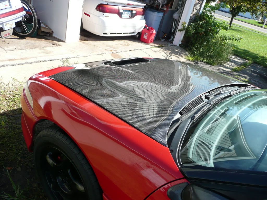

Looks great! And shots showing the new hood?

Thanks! I forgot to mention I picked up Brandon's hood! I'll have to get a couple pics of that.
Edit: ^^ Beat me to it! Like I said I'll have to snap a few pics of it soon.

Car looks amazing, question though.
Can you get a shorter tires for the 16s?
They look a little on teh fat side.
That would defeat the purpose of me buying 16's in the first place. I wanted the tallest/widest tire I could possibly fit on the car. Traction greatly improved do too more sidewall and having a wider tire. And not to mention the ride is soo much smoother. These tires measure out the same as my 26x9 Hoosiers.

Well tracton still sucks, but it was a pretty noticable difference. Here are a few pics of the hood.
http://i224.photobucket.com/albums/d...a/P1040151.jpg
http://i224.photobucket.com/albums/d...a/P1040154.jpg
http://i224.photobucket.com/albums/d...a/P1040157.jpg
