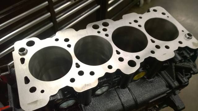

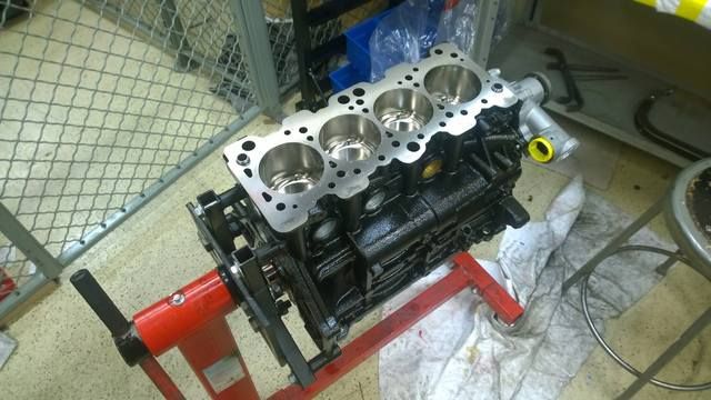

I spent most of today taking measurements of the block. I did start out the day trying to remove the extra gram two of my HD's have but decided against it. I didn't think it was worth the effort while possibly weakening the skirts.
When I measured the main bores they all measured within 2.4020-2.4018". I put the main bearings in after that and have yet to measure my oil clearance. I also took some time to shave down that 1/2" NPT fitting/breather. Please don't mind the one brass plug. Looks kinda' derp. Otherwise the paint looks alright.
http://i467.photobucket.com/albums/r...ps9x1rps9g.jpg
http://i467.photobucket.com/albums/r...psmcn2uevv.jpg
http://i467.photobucket.com/albums/r...psxa9duhke.jpg
http://i467.photobucket.com/albums/r...psvbeahn74.jpg
http://i467.photobucket.com/albums/r...psnrwvhl3z.jpg

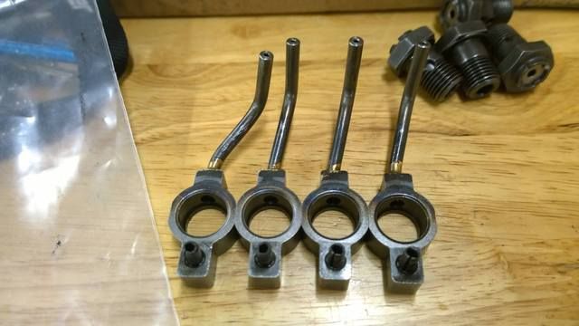

I didn't get anywhere near where I wanted to this week. I have yet to get the crank into the block simply because I forgot how nasty the oil was that Manley uses on their cranks. The stuff tool 4-5 cans of CRC brake cleaner, a pipe brush and about 200+ coffee filters to clean. Even then the counterweights and/or non-journal surfaces still leave a fine dark residue when I wipe them down.
I did do a make shift mock up on a rod and piston to bend the oil squirters..or oil squirter. Not a whole lot too it just time consuming and a tad difficult. I also won't mention I decided to grind and polish the oil passages on the block. Whoops.
So Monday I am thinking I will have a buddy help me scrub the all living isht out of the block again with water and Simple Green, then move to getting the B.S. bearings in. We may have to bend the other three squirters first though. After that I will gap the rings and install the pistons. Then boom; short block done.

LOL The only picture I took yesterday. These aren't exactly fun to set with the good old HDs. The far left if about what they will all have to look like.
http://i467.photobucket.com/albums/r...psgksg22ja.jpg

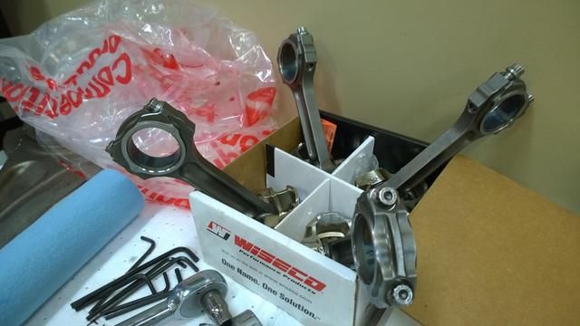

Well as of Tuesday I called it quits for now. The short block is close to being done however I was having an issue getting the rod bolt stretch to work in my favor...plus the gauge I was using was jank. So I am going to wait until I can get an ARP stretch gauge and talk to some people with more experience on torquing Oliver rods. Here's some picjars though!
http://i467.photobucket.com/albums/r...psqnn3htp8.jpg
http://i467.photobucket.com/albums/r...pspknclyyw.jpg
http://i467.photobucket.com/albums/r...psdmymfnlz.jpg
http://i467.photobucket.com/albums/r...psocgifjfs.jpg
http://i467.photobucket.com/albums/r...psarja5l30.jpg
