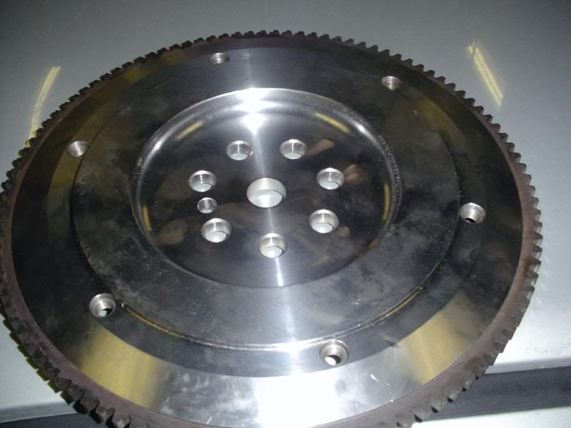

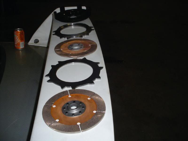

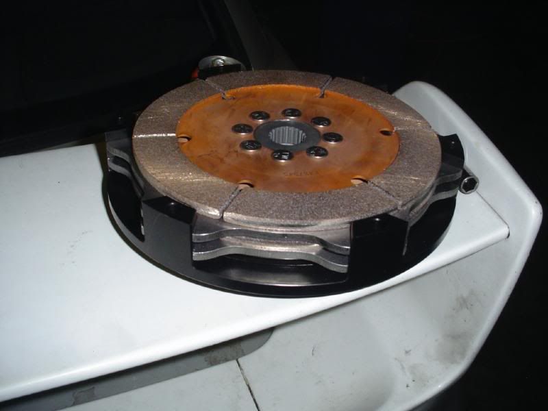

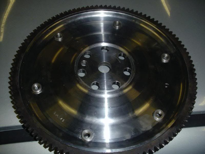

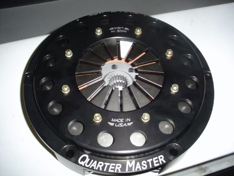

got the new clutch for the car. It is a quarter master twin plate. They messed up when they made all the fly wheels to start with. They used a 6bolt crank only to make the aliment rings on the flys then just put in 6bolt or 7bolt holes. The 7bolt crank is bigger so the fly wheels do not fit at all. Other people have the same problem sense they got theres yesterday one in OH and one in the UK all 3 of us were not happy at all about this. The diffrence in the cranks is. the 6bolt one is 3.134in. and the 7bolt crank one is 3.345in. Lucky for me my Dad's buddy has a huge laythe that will hold the fly wheel and my Dad turned it out so the fly will fit the 7bolt crank like it should have to start with.
http://i122.photobucket.com/albums/o...o/DSC03674.jpg
http://i122.photobucket.com/albums/o...o/DSC03676.jpg
http://i122.photobucket.com/albums/o...o/DSC03675.jpg
http://i122.photobucket.com/albums/o...o/DSC03679.jpg
TkrPerformance 03-23-2008 10:29 AM
Re: the evo 3 swap parts are coming

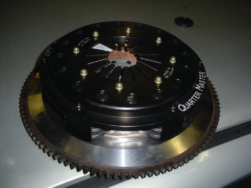

this is what had to be turned out bigger. just the aliment ring
http://i122.photobucket.com/albums/o...o/DSC03678.jpg
it all together
http://i122.photobucket.com/albums/o...o/DSC03680.jpg

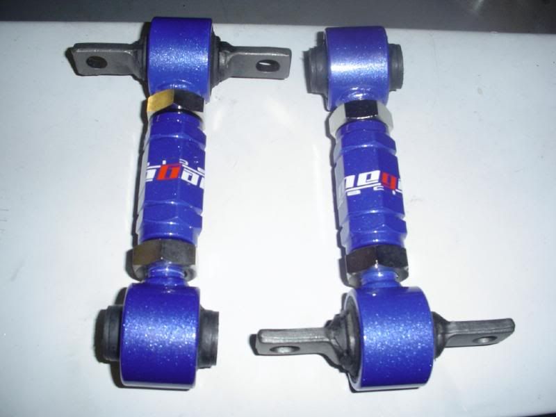

also got a set of megan racing rear toe arms
http://i122.photobucket.com/albums/o...o/DSC03677.jpg

TkrPerformance 03-24-2008 09:21 AM
the color has been gone trough many times already. I will paint it when it gets warm out and have some time to do it. I went with the twin disk because the 2900 went out in a year and it is not fun taking the car apart at all so I did not want to do it a 3rd time.
