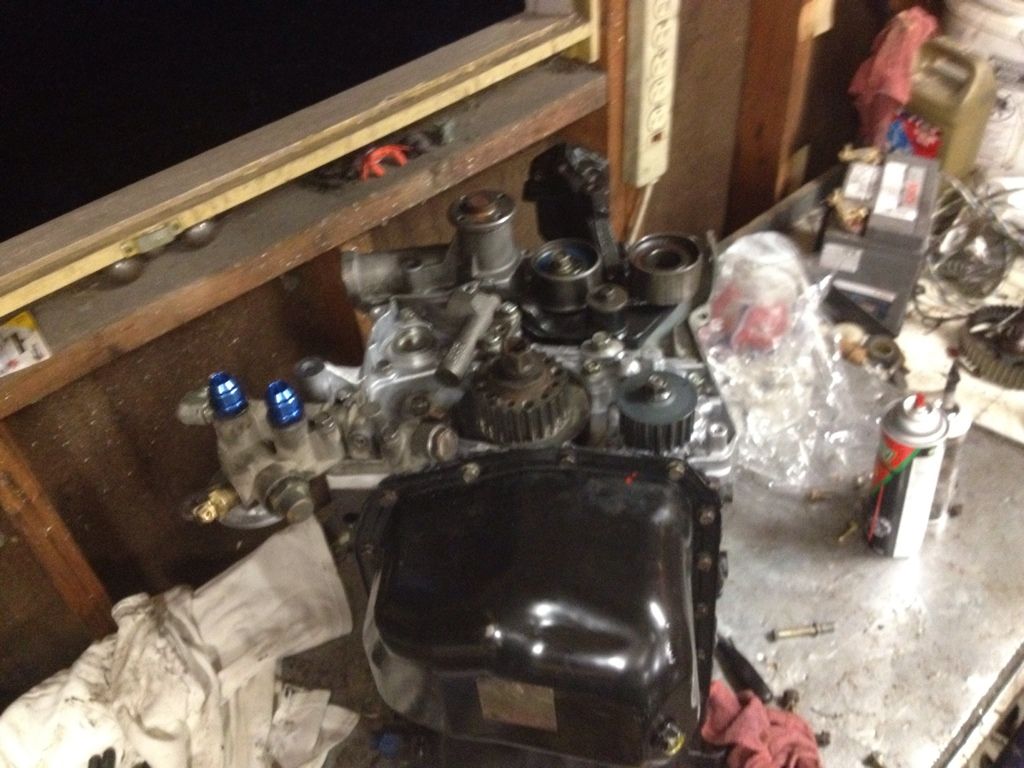

Started to put the bottom end together tonight also. Gosh will have the head all done on Friday. So next week end it should be back on the road
Putting the engine together on the bench since the engine stand has the sbc 383 on it right now.
http://i122.photobucket.com/albums/o...A28BD94987.jpg
The new bottom end
http://i122.photobucket.com/albums/o...A2B53D991E.jpg
http://i122.photobucket.com/albums/o...A29584814B.jpg
Also ordered a 10an fitting for the Evo 3 16g should be here soon.

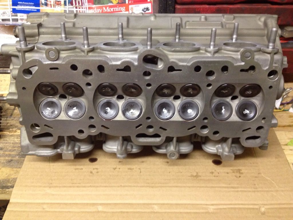

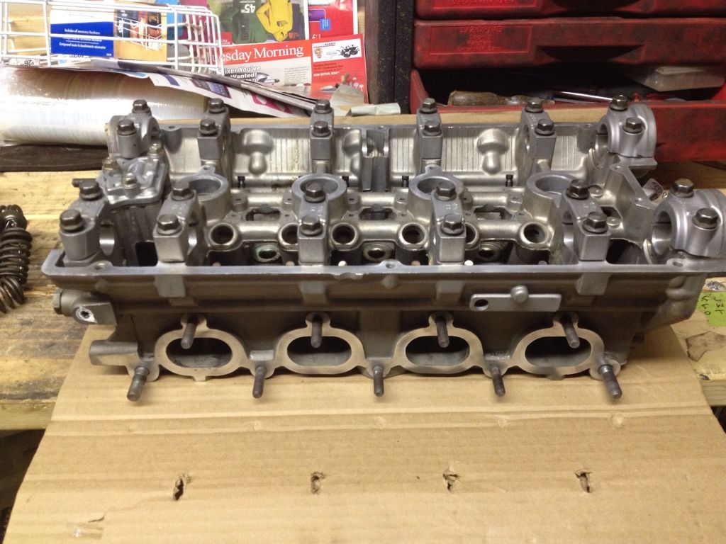

Aly picked up the head from gosh yesterday. No I just have to put my free set of Evo 9 springs and retainers in it.
http://i122.photobucket.com/albums/o...008C094689.jpg
http://i122.photobucket.com/albums/o...00BD0D64F6.jpg
http://i122.photobucket.com/albums/o...00B7242203.jpg
Goat Blower 09-14-2012 08:31 AM
Re: after 10 years its coming back to life
Identical head setup to mine, should be lots of fun.

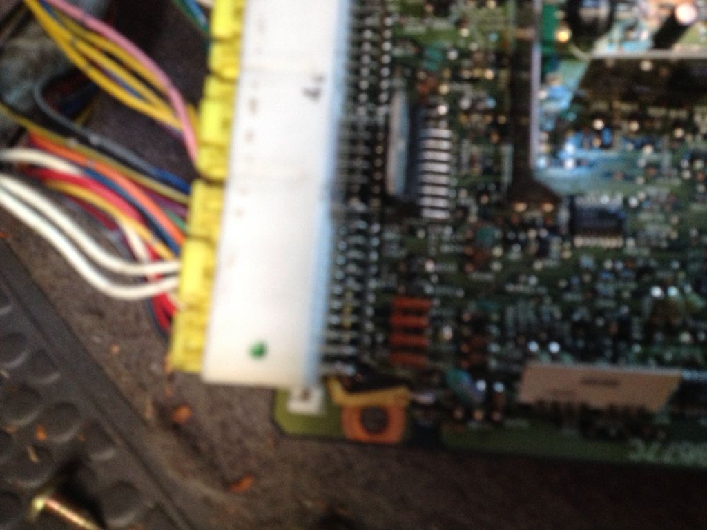

Well the Spyder is down for the 2nd since it has been running. Made it to hwy 7 on 169 on the way to work today. Shitty thing is I sold my spare EPROM to put it back together after the motor died the 1st time.
http://i122.photobucket.com/albums/o...D2512F0F10.jpg
On another note. I have a turbo on the way. Got a 50trim for a great price.
Got it fixed it was burnt all the way to the pin. Found out the o2 sensor was shorted out and burnt the trace off the board. Fixed the o2 sensor also. Now the car pulls all the way though 30psi.

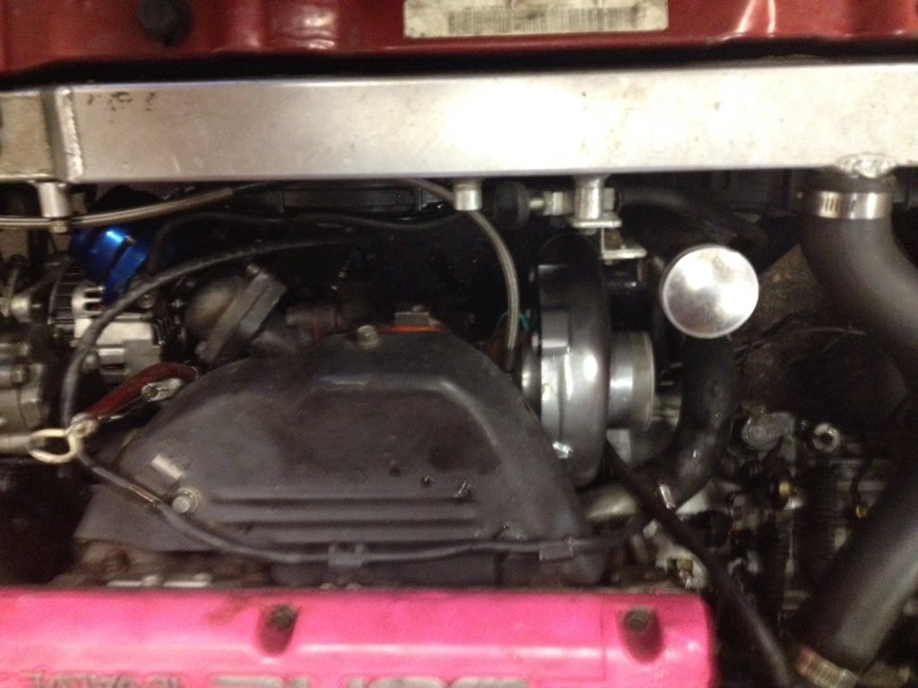

picked up a pte5031e for dirt cheap that is in great shape. the hot side was decked flat both flanges and the cold side was powder coated almost chrome. Will be taking off the evo 3 turbo on my weekend and putting the new turbo on. The only thing it was missing was the hot side clamps. It just had the bolts holding it lucky i still have the bad gt40 and took them off that and reused them.
http://i122.photobucket.com/albums/o...FCE060B69E.jpg
TkrPerformance 10-22-2012 10:45 AM
got the new turbo put on. Also found out the e3 16g is just fine and was not the smoking problem. So it will be up for sale now.
http://i122.photobucket.com/albums/o...DAF917FD17.jpg
http://i122.photobucket.com/albums/o...DB06A688DC.jpg

It was the way the catch can was made. It was the one that was in the hatch back and was not hooked up. I bet that is why it was not used at the time. It is now fixed Nd working like it should. The intake pipe have 1/2 a qt of oil in it. Going to make a 2nd can for the breather to intake pipe tomorrow. Car works good now pulls all the way to 30psi.

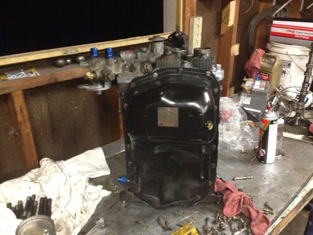

lifted the head ho the way to work yesterday. ended up dumping oil in to 2&3 and out the front of the block from one of the head drain holes. Also now the pte5031e has good side to side play.
so
head has to go back to gosh to be cleaned and checked a 2nd time
new head studs
new head gasket
find a timming cover (it broke taking it out)
Get the pte 5031e fixed or have it made in to a billet pte50 for around 600.00 (all new but reuse my hot side)
