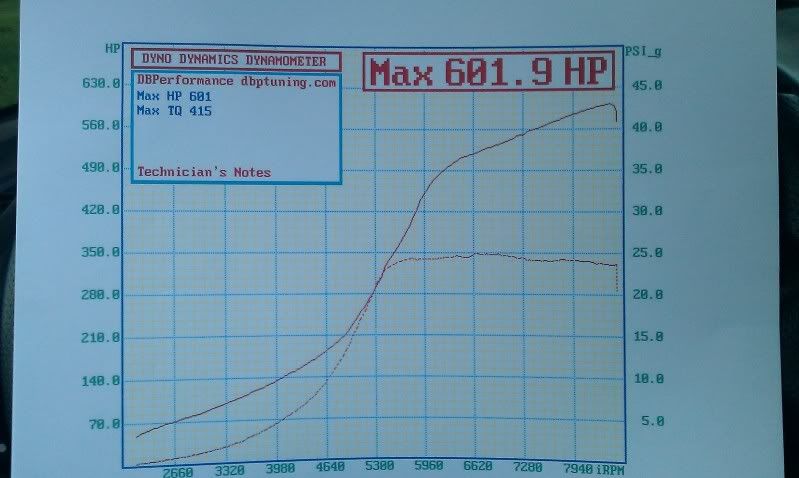

Got back to the dyno with Fuel Injector Clinic BlueMax 1450cc injectors - had 1000s before and they max'd, max'd out the single modded walbro on E85, 24-25-24 psi same everything else including Competition Clutch Stg 2 (rated for "350 tq") clutch on a base RSX 5spd.
601whp/415tq - stock unopened/untouched longblock!
THANKS SHANE!!!
These were 3rd gear runs.
http://img.photobucket.com/albums/v17/guessd/hptq.jpg
Here's the boost chart - see how it barely touches 25 then goes back to 24
http://img.photobucket.com/albums/v1...sd/hpboost.jpg
and the a/f chart
http://img.photobucket.com/albums/v17/guessd/hpaf.jpg

Wow. 601hp on stock longblock is nuts. car must be very interesting with more power. Any plans on a built tranny?

pffttt nope. $4500 = built tranny = not gonna happen.

The 1450s with the proper fuel pressure from a non-maxing fuel pump should max somewhere between 7-800.

Shootout/DJ corrected.
